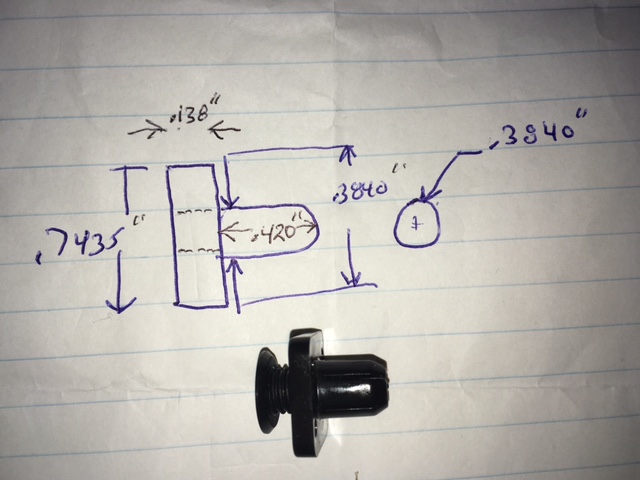

Originally Posted by kenchan
u have to go REAL easy on those tabs.
at this point you'll have to break them off I suppose. hold the screw head with a straight pick tool to prevent it from spinning and drill a small hole next to it. just drill through and pull out the screw portion.
I picked up a few at the dealer. They had to order them, they don't stock them. Now that seems strange and confirms why some people having their oil changed at the dealer end up with the shield coming off.
Part Number 91514-TG1 T01 .75 cents each
