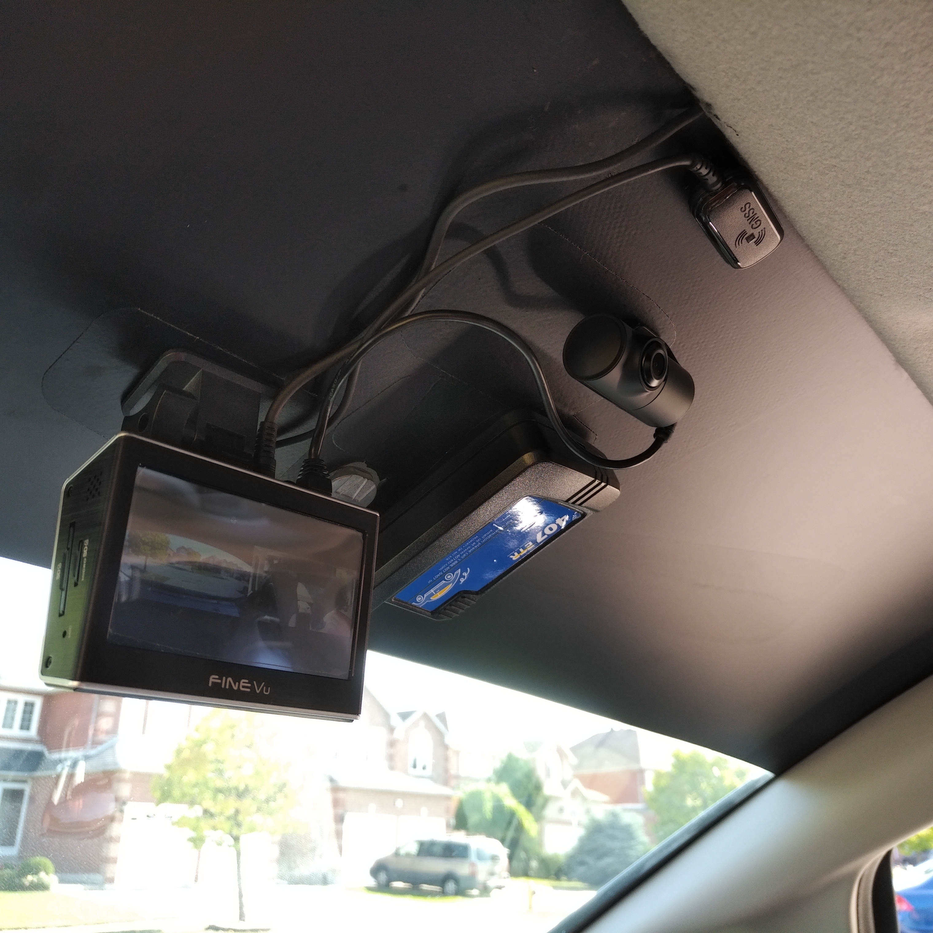

I put my rear camera on the inside of the car facing backwards. That way the camera will be able to see almost all of the rear side windows, and part of the front sides too.

That's an interesting idea. Do you have any photos or rear dash cam video links?

Action Jackson's Avatar
Joined: Oct 2015
Posts: 1,366
From: Ontario, CANADA
Old Sep 22, 2017 | 11:13 PM
RavenManiac's Avatar
Joined: Jun 2017
Posts: 52
From: Williamsburg, VA
Nice. Thanks for posting the images.
