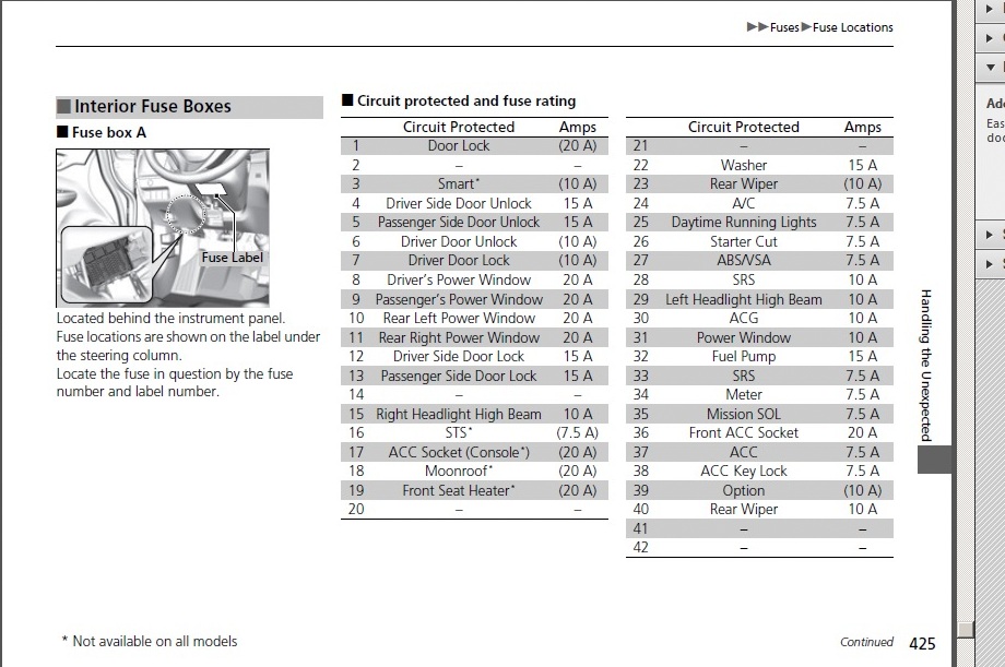

I'm getting ready to install a dash cam in my son's 2017 Honda Fit EX and I need to find a 12V switched power source to tap into. My thought was to add a FuseTap to one of the Fit's interior fusebox fuses.
Does anyone have a suggestion as to which one I should use? Does anyone have a link to a diagram of the interior fusebox?

Tap off #25 fuse under the dash that is for daytime running lights, 7.5 amps.
Attached Thumbnails 2017 Fit EX-Adding a FuseTap?-fuse-box-page-425.jpg   2017 Fit EX-Adding a FuseTap?-fuse-box-under-dash.jpg

I'm using the fuse for the rear wiper.

I know it's off topic, could you please show the fuse for the cigarette plug (mine's not working) on the center console. I tried couple of times using the manual but no success.
