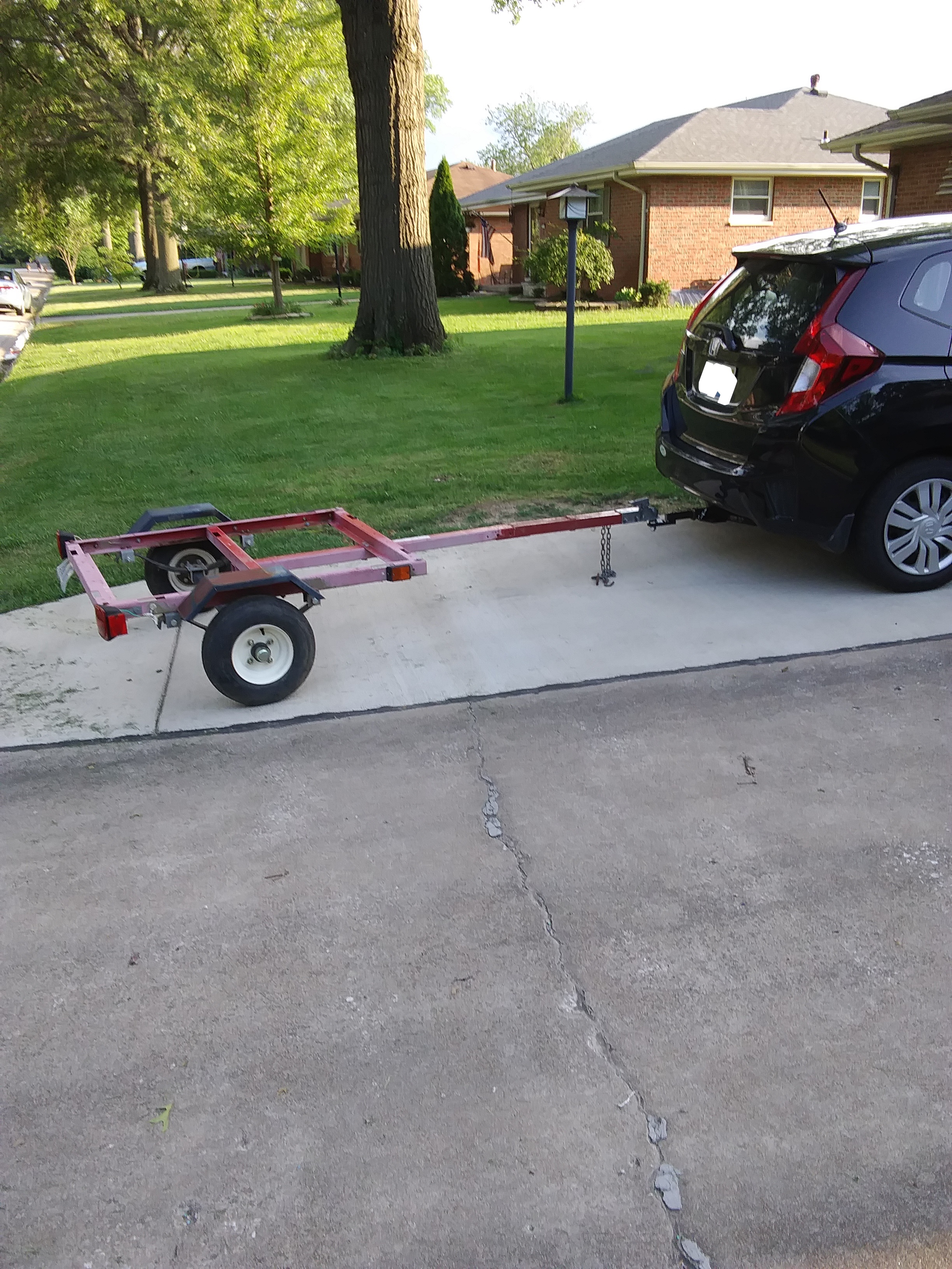

Here's my set-up. That is a Harbor Freight trailer. I extended the tongue a few feet. I'd like to tow a white water kayak that weighs less than 30 lbs about 30 miles each way. Think my cvt can take it if I'm careful and don't goose it?

id be worried about brakes. even with no towing the GK's brakes are horrible
If the CVT can't handle an extra 30 lbs, I'd sell the car and buy something else ...

I'm thinking if the total weight of the trailer and load are =/- than the carrying capacity of the car I should be ok.
I should be close. I could always pare down the weight of the trailer. Just give me my Sawzall and my welder and turn me loose.....

Took it for a test drive without the 30 lb kayak. It did fine, maybe a little bouncy. I can't see it in the rearview mirrors unless on the corners.

You can do it, but it's probably not a good idea for CVT longevity. In other words, you'll have towing miles, but fewer overall miles out of that CVT. Your call.
We already know of a 2015 CVT recall for a drive pulley shaft made of metal with questionable hardness. It tended to self-destruct and result in catastrophic failure, often long out of warranty. So Honda is in effect, using the public as a GK5 beta-tester to help refine their CVT product. The situation is not as straightforward as a conventional auto or manual transmission.
Don't get me wrong, I love my CVT, and this from a guy whose previous seven vehicles were all manual. I just wouldn't push my CVT any farther than I had to, unless I liked the idea of replacing it long before the rest of the car called it quits.
