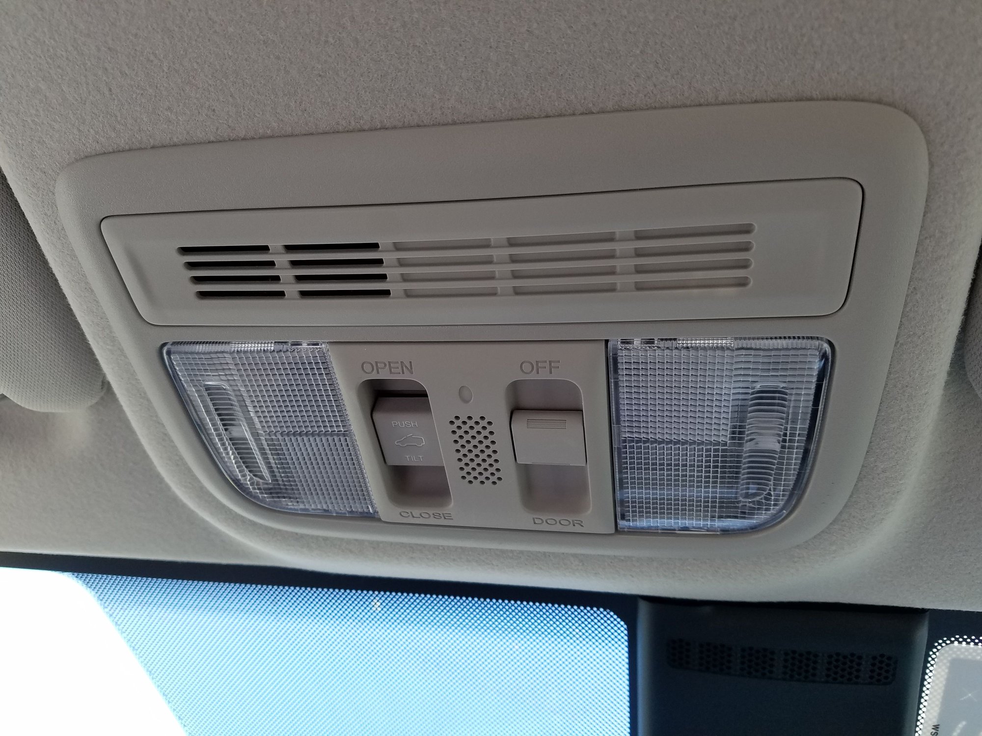

What is this vent near my map lights?
What's this vent looking thing near my map lights and why is only 1 portion of it open?

Microphone

Oh wow I literally would've never guessed that, thanks!

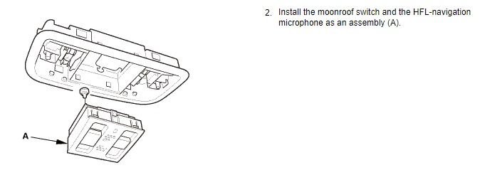

There is also a microphone in between the switches.

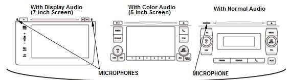

Depending on your audio system there are also microphones on the front of your stereo.

Why so many microphones, and so close to one another?

Noise cancellation, I believe. Accords also have microphone in the rear of the cabin.

yah, its a beam forming mic. limits the area the mic picks up audio.
the rear accord mic is used for active noise cancellation.

It's how the system picks up the driver's voice so clearly. If you RTFM, it says that attempting to give the system voice commands from the passenger seat won't work well. That is because these multiple mics are tuned to pick up sound coming only from right in front of the drivers headrest(roughly), to give the best quality voice pickup and background noise cancellation

yah, that is called beam forming mic. not so much noise cancellation on this mic, mostly noise isolation.
but the quality of the fit's mics are pretty bad. dont ask how i know these things.
