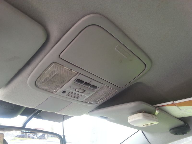

anyone install aftermarket map lights on their 1st gen fit? I have an 08 LX and I really want map lights. thanks.

Map lights out of an accord fit nice. Had to chop a lot off the sunglass holder to make it fit but it's still functional.

very nice. do you know what year accord it was, approximately?

geopat, a couple of other questions. What do you mean by sunglass holder, that you had to chop inches out of. And, you don't by any chance have posted a step by step, how you did it? thanks. It looks great.

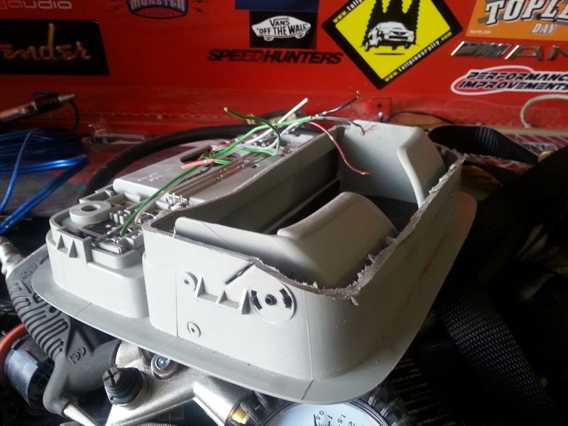

It was an 06 Ish coupe. Had to take a little over an inch off the back side of the sunglasses holder. I'm eventually going to do a write up just need to find some time to draw the wiring out. Everything is just tapped into the stock dome light if you are just adding in the map lights it's just a matter of matching up the wire colors. I wanted this for the garage door opener.
That's what it looks like from the back side.
