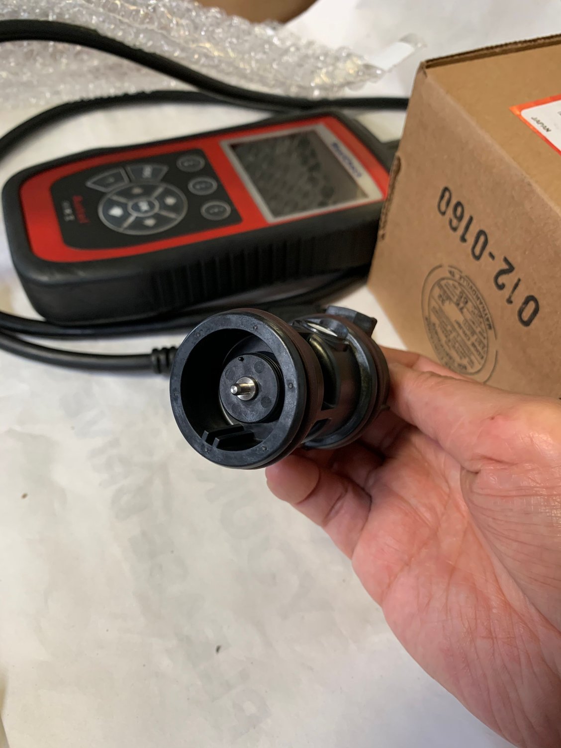

mind sharing with us some photos of that vent valve solenoid?
Old Jul 18, 2019 | 06:04 PM
payluder's Avatar
Joined: Aug 2014
Posts: 179
From: Some where
can’t really tell from the outside if it’s broken. But had it tested and it does in fact was stuck inside.
