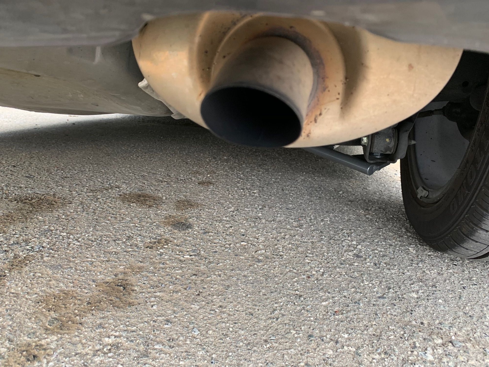

Thank you for all the suggestions and feedback I did look at fuel related topic and haven't pin point a solution and after 25 page I gave up.
My tires are new I replaced them a month ago and checked that they are all at 32psi. I only use the car to commute to work so I can say 85% of the miles is freeway miles and I do not drive hard. I changed my air filter to the rechargable K&N but not sure that it will affect the gas mileage. I also got brand new brake pads and rotors not too long ago but the bad mileage has been there before the rotors and pads were changed. I live in the bay area and rarely use the AC.
I do have a full system in the car which makes the car heavier and I drive with 2 baby seat all the time since after work I go straight to pick up my kids. One of the seat is 20lb the other is just a booster.
https://www.fitfreak.net/forums/3rd-...m-install.html
I do suspect there is a leak somewhere and Im afraid to bring the car to the dealer because currently I dont have the funds if its something major. So Im reaching out to see if there is something I can do or change myself.
Thank you

I would say your exhaust look normal compared to my exhaust.
