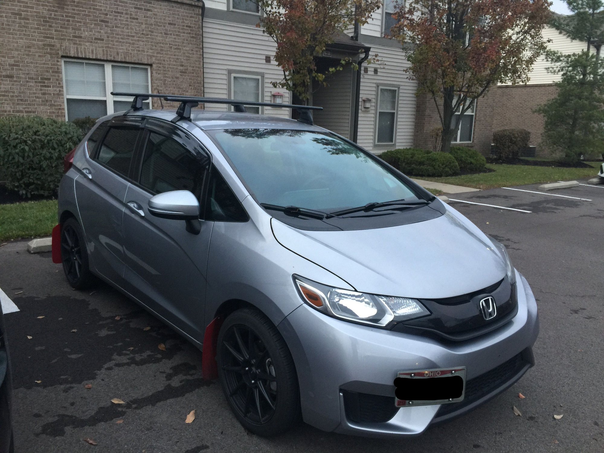

I run Advanti Storm S1 17x7 +35 offset wheels with 205/45R17 (Also rally armor universal flaps). I'm on stock suspension and have rubbed exactly once on my drivers side front wheel; while driving at 65 mph, turning, and hitting a big dip on the interstate. Even when it rubbed it only hit the liner and not the metal. I like the flush look on the front and the rear top edge is about 5-10 mm in from flush with the fender. You can use tire rack's wheel website to find wheels that will fit your car and see how they look.
