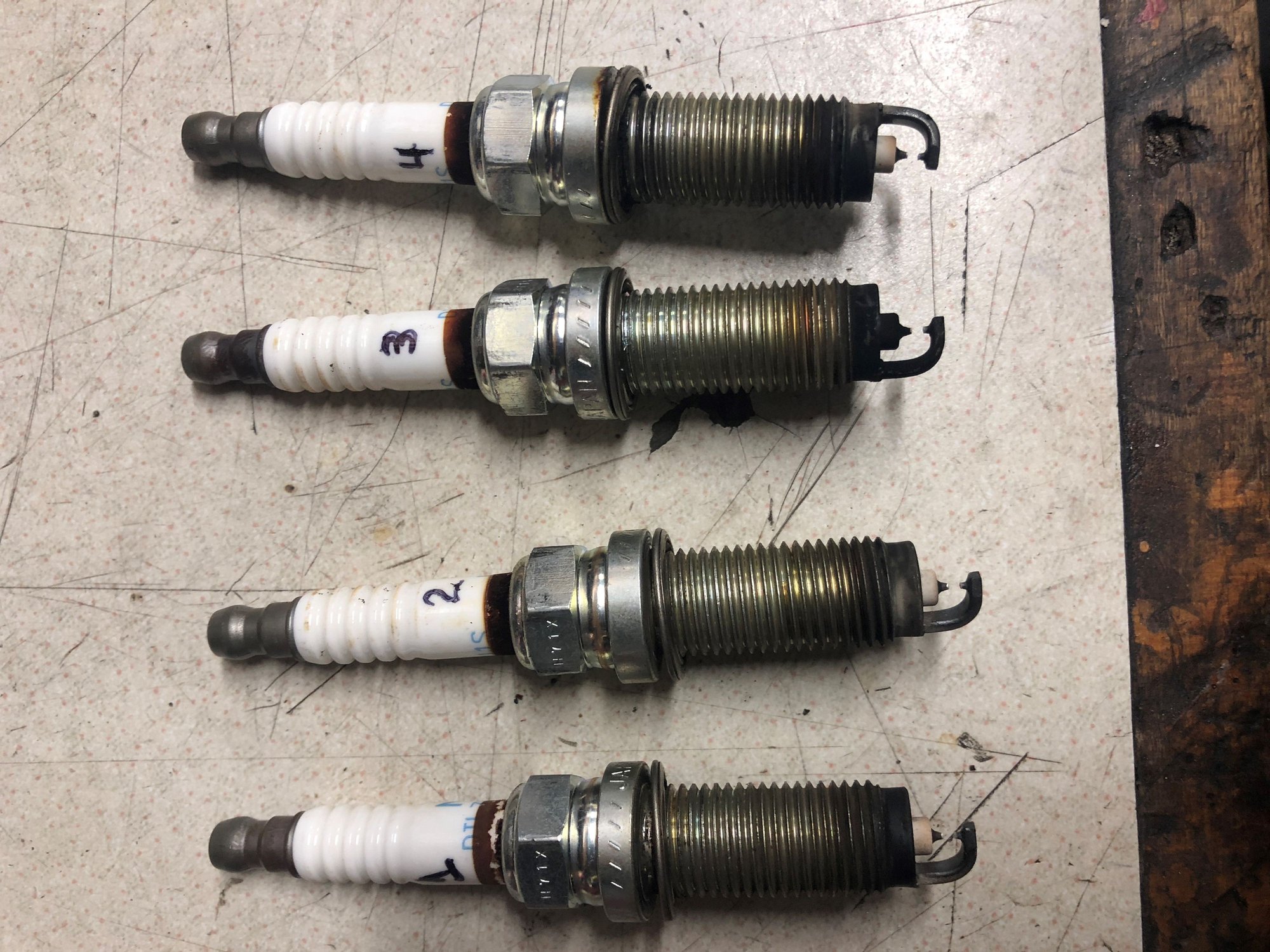

Unplugged MAF sensor and car ran significantly worse, and started throwing codes about it, so I’m pretty sure this component is working. I’m able to make the car throw P0303 codes if I hold the rpms at 2500k, you can hear it backfireing, and eventually a limp mode is produced. At that point car won’t rev over 2k. I’ve closed what the plugs look like about about 15 miles of driving. Notice how black the 3rd plug is. Super rich!! Maybe a bent valve? Compression test or will be hear tomorrow.

I tried to upload pics of the plugs, but they are lost in cyber space somewhere.... 3 are golden brown, one is black as tar, cylinder 3. Gonna compression test it tomorrow, and see whats going on. Not sure what the psi should be, but if 3 is considerably less than the other 3 cylinders, then ill know, its fatal.... I also noticed tonight, the fuel pressure is registering 500 to 700 psi!!!??? is that right? When I unplug fuel pump, car idles perfect, like a kitten arounds its mother. course I have no power, but it sounds great!! disconnecting the fuel pump brings the pressure down to 40psi, which I would think is acceptable, not 700psi... if anyone has a fit they can plug in, and tell me what they see, id be so grateful!!! unplugging the MAF sensor made the car run terrible, so im assuming its working right.

GAFIT, thank you again for another reply! I wish the pics of the plugs would show up, or maybe they did in some other forum... Plug #3, is not wet from oil, but very sooty, like an over rich scenario. But that is one system i have not looked at, ill check the PCV valve and make sure its clicking. The highest fuel pressure i have seen is approx. 750psi @ 3500rpm. I should get my compression tester today, and I'm hoping for good numbers, 120-140psi(?), that would rule out a burnt valve scenario. As for maintaining the car, i can say the customer said he did regular oil changes, and when i pulled the valve cover, it was evident of good oil changes. As for selection of gas, he buys regular gas at FastTrip, a local gas station to him. The valves looked terrible, when i looked into the intake ports. Again, i cleaned them up the best i could from the intake ports, soaked them, and scraped the sludge off. When I was done, they looked pretty good. The local dealer also pulled off the intake, took one look, and said your injectors are leaking and need to be replaced. They quoted him 1700.00, he declined, and was charged 390.00 to remove the intake, and inspect the valves.

Yeah, that #3 plug shows signs of being super rich in that cylinder. It might have a leaking injector, but I would only replace #3.
