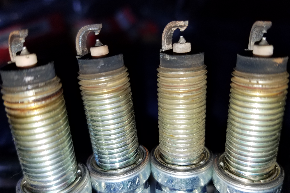

At 120k miles. They're in order of 1 to 4... Plug 3 was pretty ate up.. the others weren't that good either.
Easy to change, IF you have the right tools... 14mm deep well with 3" extension and two 2" extensions.. Put on the 3" extension and lower in the hole add 2" extensions as you go!
There was some rust on the coil boots from the steel liner. I added some dielectric to the seal to help out...
