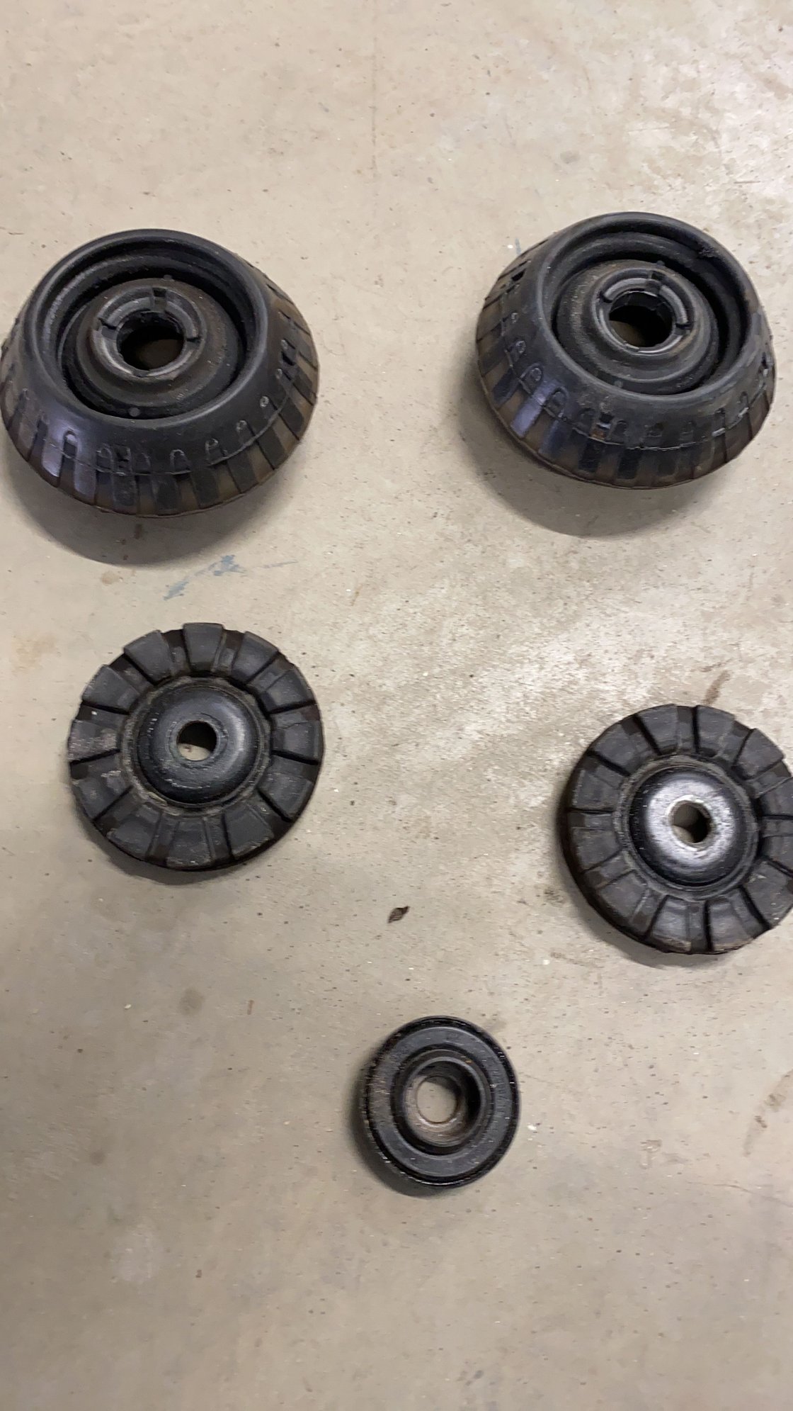

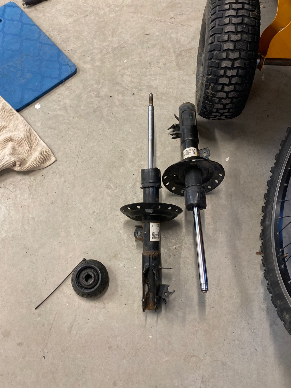

I pulled the struts on Thursday. I replaced them with the KYB’s new lower bushings, strut bearings, and upper rebound bushings. It was incredibly easy to do on this car. The sprigs are not super strong because they are so tiny, so I didn’t have the fear and anxiety like other springs while using compressors. The bearings had a lot of play, one fell apart when removing it. The lower bushings were pretty worn in. As were the top ones. I’ll put a picture in below. As a side note the nut holding the strut together was frozen on so I cut them off. I had new ones for it.
After replacing them I was too beat to drive the Fit, plus I wasn’t getting in the car dirty lol. So... Yesterday I took it for a ride in the morning taking my wife and daughter to work. And after all the times I took it to the idiots at the dealerships(they have 2 separate ones, same owners), and telling them there’s definitely something clunking up front, to which they said their “master techs” said there were no problems. And the first thing I tried was replaced the end links, it was not them. Guess what? It rides like a nice new QUIET car. No more clunking, just normal tire noise from the roads like every car out there. It’s night and day. So the dealership I bought it from just got 2 nice reviews from me how much they suck for making it look like I was crazy or hearing things. “Nit picking”. I’m going to apply to be a master tech, because I knew there w
as a problem, whereas these other “master techs” couldn’t find a problem. Yeah of course they strung me along until the 90 day joke of a warranty expired. I spent $580 of my own money and did the work myself, but I love the way it rides now. so F Lundgren Honda of Auburn, MA, and the Greenfield one too.
