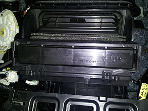

How to replace or clean the cabin air filter in your GK.
Difficulty: Easy, hardest part is step one!
Time required: 5 Minutes
Tools required: None (flashlight optional)
Honda replacement: 80291-T5R-A01
1. Open glove box and clean it out. If you can do this without breaking down and crying, the next steps will be a piece of cake.
2. Press in on the sides near the top of the glove box and swing it down. There is a little bumper on each side:
3. On the filter cover, push in on the tabs on the sides and pull out.

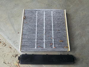

4. The filter can be pulled out. Make note that the arrow is pointing down for airflow. Also there is no "frame" like previous models:
I chose to just clean mine by turning upside down and tapping on the sides. This let loose lots of dead bugs and leaves etc. My GK has about 11200 miles on it and the service interval for the cabin air filter hadn't come up yet. I was just curious to see what it'd look like.
5. Installing the filter is just as easy. Make sure to install with the arrow pointing down.
6. Reinstall the filter cover with the arrow pointing up.
7. Push the sides of the glove box together and push to close. Return junk back into glove box and you're done.
