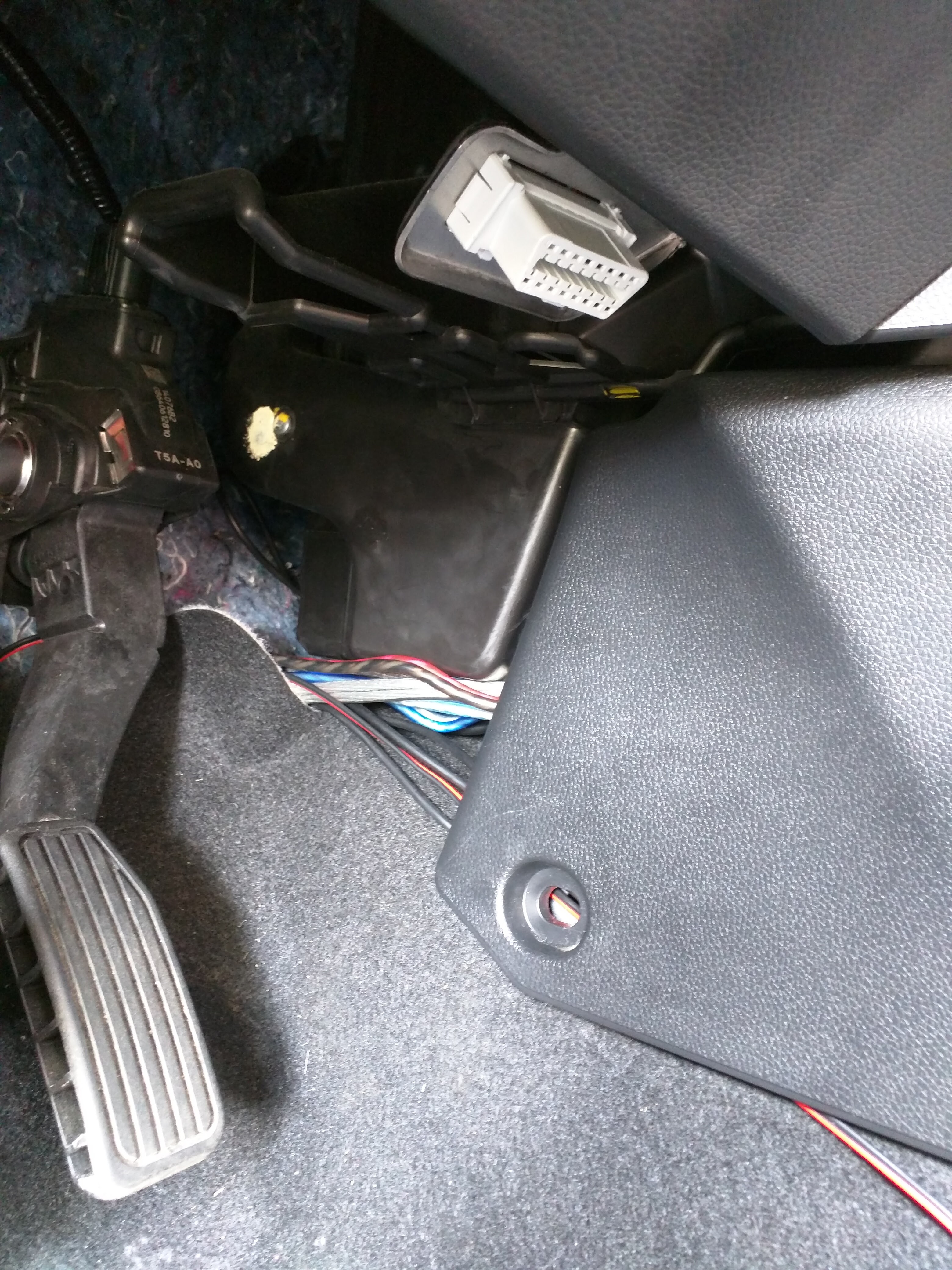

Here are some pics....
Green is ground, blue is power

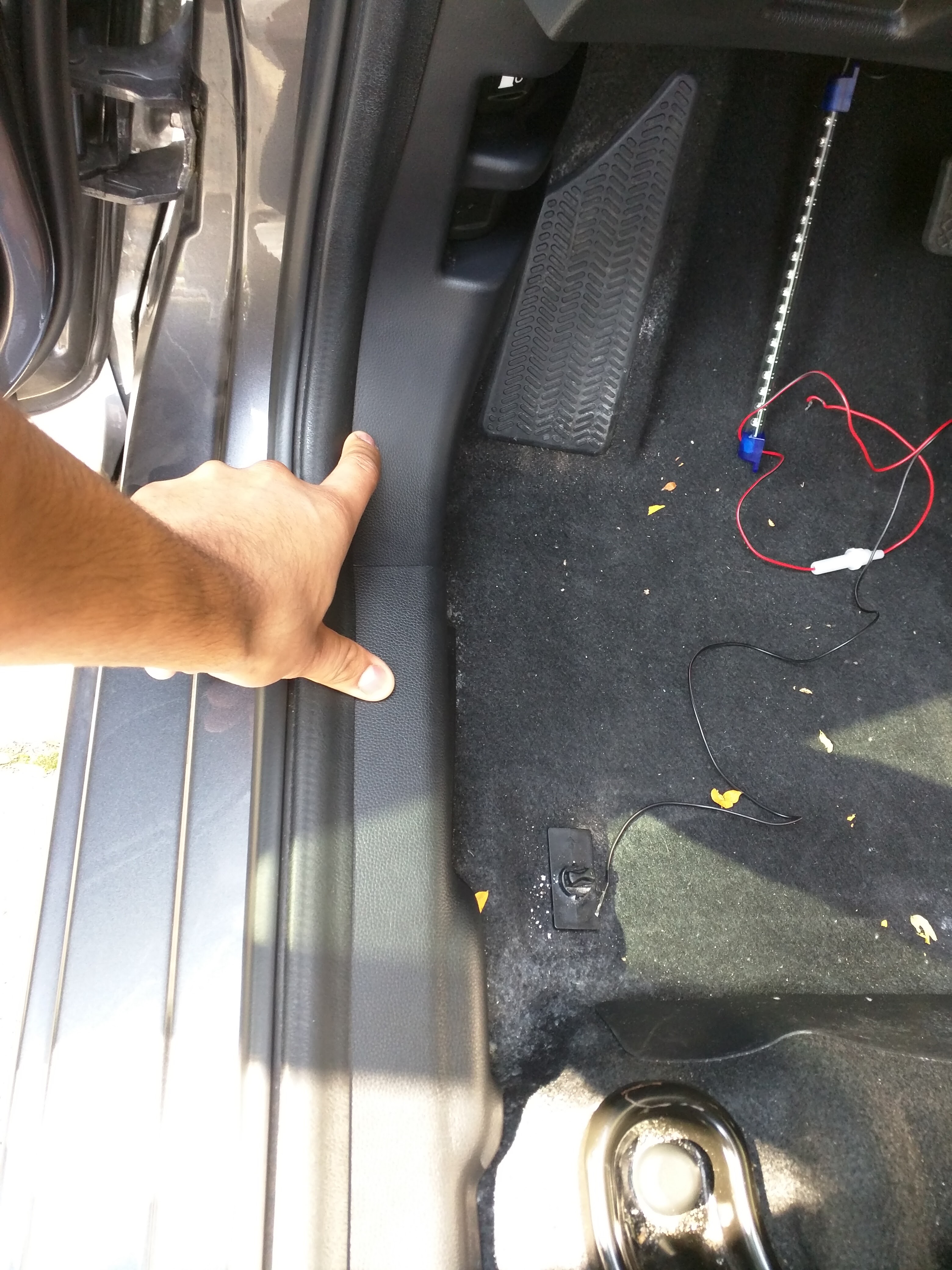

Remove those two panels, be careful putting it back on....I broke the green pins

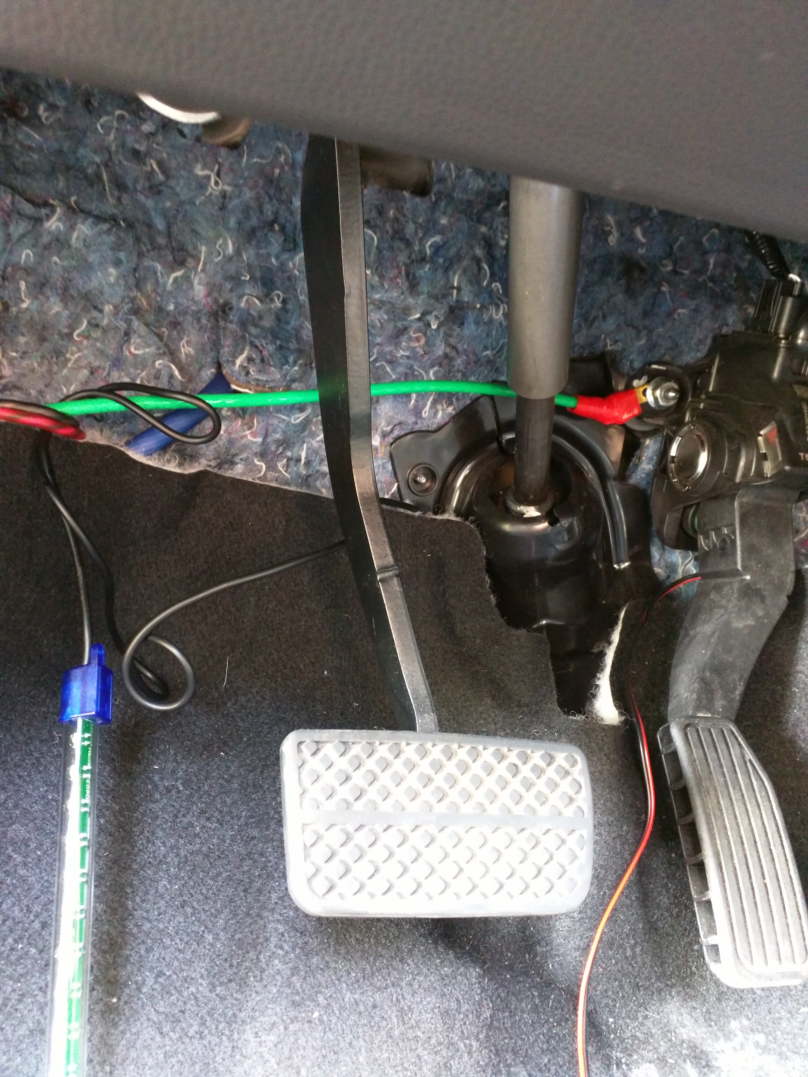

Notice the factory opening. Remove the seat.... there are four bolts

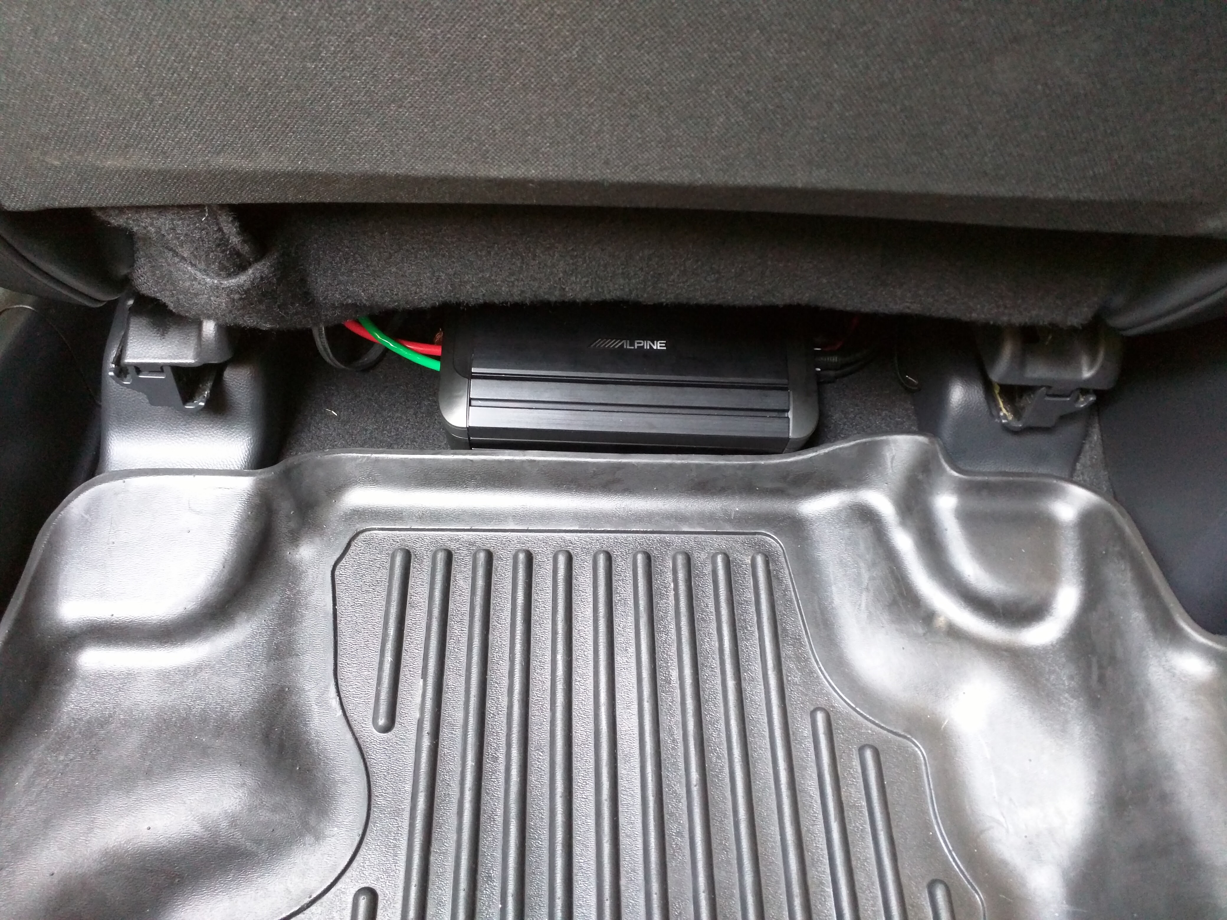

Amp under the driver seat.
