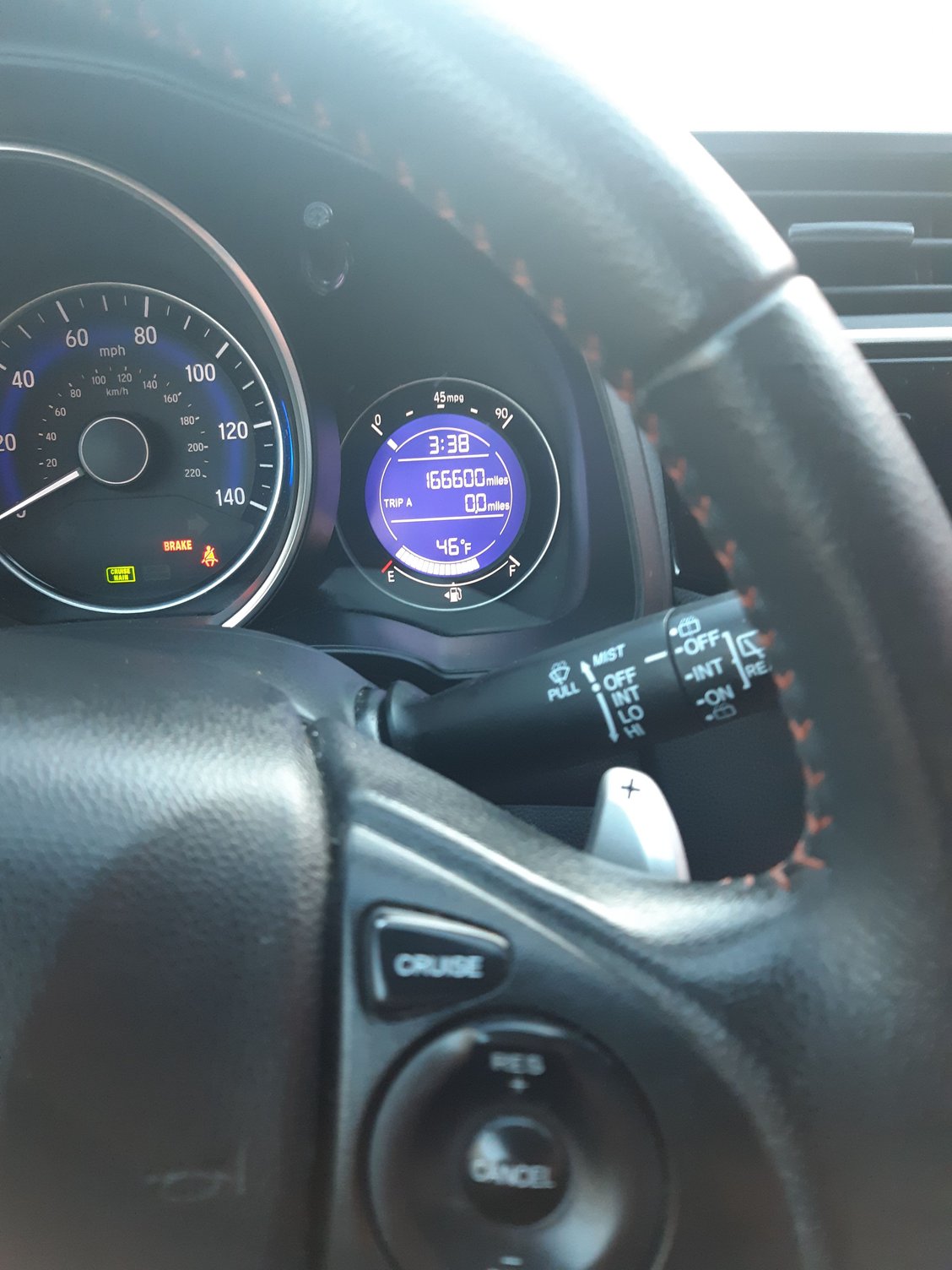

At almost exactly 75000 miles I got the dreaded bunch of Dash warning lights on the left of the speedometer the one that shows up in some of these people's posts it was intermittent at first and I noticed it was turning off my cruise control but not stalling out the vehicle so after a few weeks I brought it into the dealership by this time the injectors running rich had fouled up the catalytic converter and that had to be replaced 4 injectors plus a catalytic converter as you can imagine just the injectors were around 2,000 at the dealership plus catalytic converter which is almost the same. The only other option would be an independent shop and all the independent shops around where I spend most of my time are about a two to three-week wait to get your vehicle in for service.
Latest setback was another 75000 miles exact same symptoms happen again with the warning lights and I brought the vehicle into the nearest dealership I could find witches in a rather nice area and pretty reputable but different from the dealership where I bought the vehicle at. Next morning sure enough injectors we're throwing a code for running rich and we're falled I needed to be replaced $2,000 luckily the catalytic converter was fine this time. I had to wait an extra day for parts because a Honda Fit that was just brought in a several hours before me head the same issue it was a 2015 that just got up to 75000 miles and the injectors went out just as minded sorry to wait an extra day for the car to be finished at the dealership but three days without my vehicle is lot better than 2 to 3 weeks. So everything was good then at a hundred fifty thousand miles but I figured shoot I better get rid of this vehicle before 220,000 miles rolled around.
today I'm sitting at just under 170000 miles 166k to be precise my brakes I've never been replaced there still performing well but down to 2 millimeters on the pads, they will need to be replaced too soon also the alternator is starting 2 not perform where should be at I get to make headlights at low idle especially if the AC compressor is going.
in case you're wondering I bought the vehicle in July 2018 it has served me well despite the costly repairs but I figure it's time to move on with this many miles I'm facing getting nickel and dimed to death with various repairs that will come up as the vehicle approaches and goes past 200,000 miles I'll throw in a few pictures if I can get them to upload from where I'm at. Soon-to-be farewell, fit freaks
