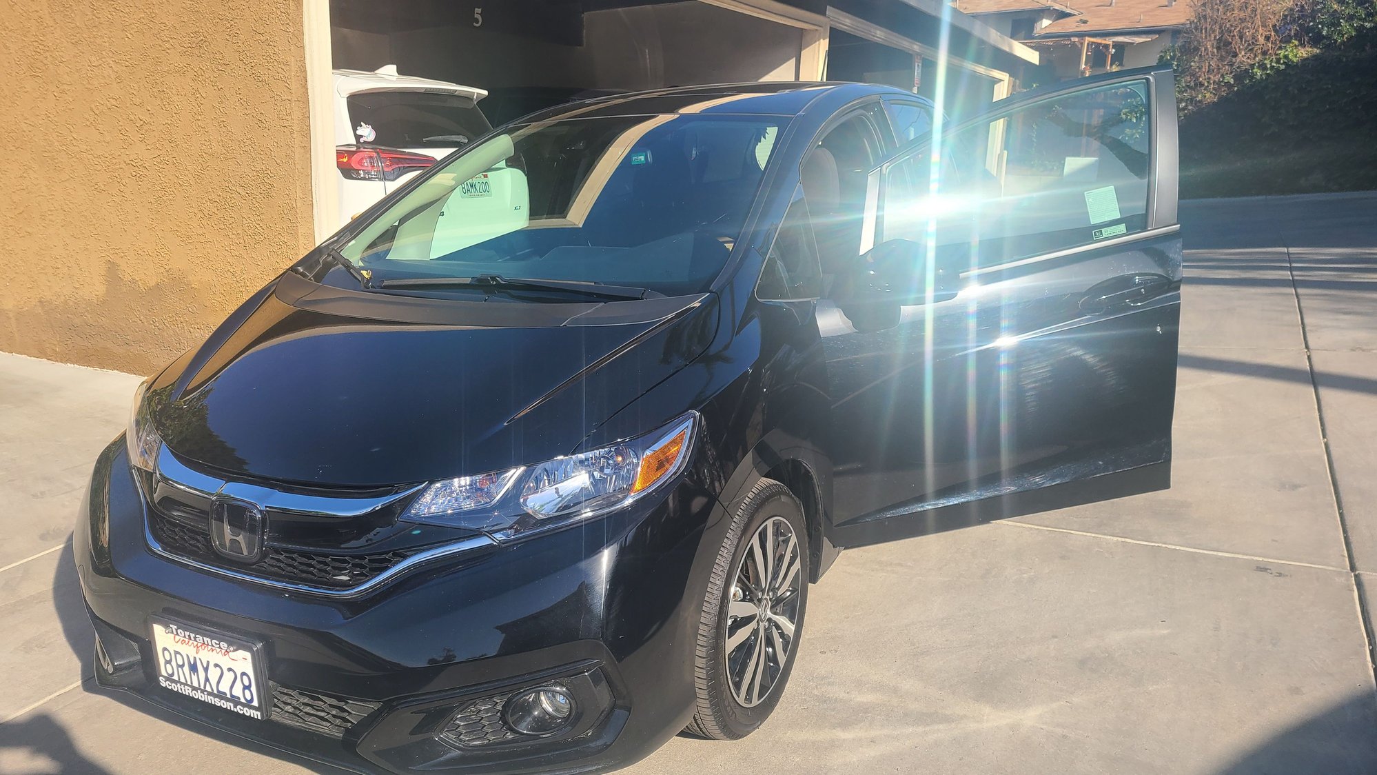

This was my 2020 EX I bought 2/27/2021. The pictures are from the next morning.
day 1
Day 1 new car

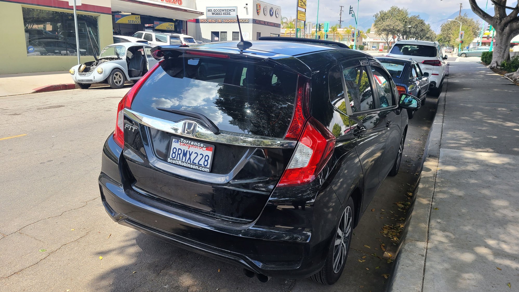

And today, I finally got my Ikon Motorsports RS replica spoiler installed. To be frank, Its not the best fitting spoiler, but you get what you pay for. It doesn't sit flush, it needs to be pushed back slightly to avoid rubbing and catching the top when the trunk lid opens. The brake light is not a Plug n Play, I need to take the OEM one off the old spoiler to make it work. (doing it tomorrow) It only uses 2 of the OEM bolt holes and even then, becuase it does not sit flush, there is a gap in between the car and spoiler. It also exposes 2 of the other OEM bolt holes that I need to cover and also need to delete the windshield wiper sprayer, or find a new way to mount.
Lowkey, I honestly think the shop I went to probably could have done a better job at installing and painting, but I went for cheap and affordable. So, my fault I guess.
Installed
back view
the OEM bolts show. Need to figure out how to cover those.

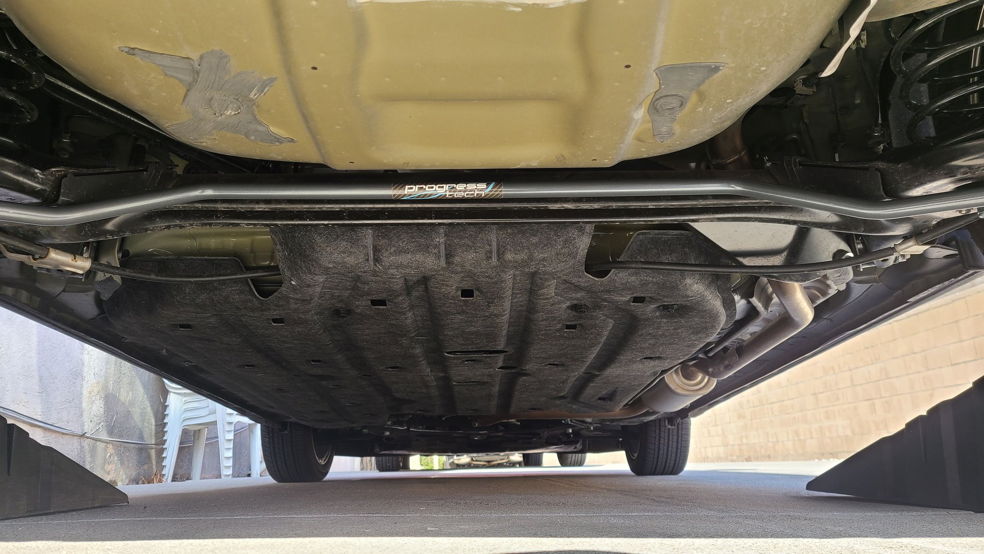

Today I put the car up on ramps and installed the progress rear sway bar. Noticeable difference in the way it drives. My buddy and I also reworked the RS spoiler and it is 10000000% better than the shop left it.
We took the wiring and plug from the OEM light and attached it to the RS wing light. Then, because the wiring holes didn't match up, we drilled put about a 1.25 inch hole in the center of the wing to make the harness sit flush against the trunk. It ended up lining up with the stock OEM bolt holes so we used that, and double-sided tape to secure the fitment and help with water protection. Overall, way better than the shop left it. But, it is what it is. It looks much better now.
Before going on
Progress RSB installed.
Perfect fitment

Sweet mods! Does the Progress bar have any rubbing issues or anything? I really wanted one but got scared by people saying that there was problems with it hitting the spare tire well? If not I’m ordering one of these soon. Keep it up, your fit looks great!
Old Mar 22, 2021 | 02:40 AM
chittymongorian's Avatar
Joined: Feb 2021
Posts: 76
From: Los Angeles
Not that I have noticed yet. After installation I didn't hear any extra noise. Supposedly, if you install on ramps instead of jacked up, it helps eliminate the rub or noise. I read that online in the forum. So I did that and nothing yet. I definitely feel the difference. I'm on stock suspension, so it now feels alot tighter when turning and cornering

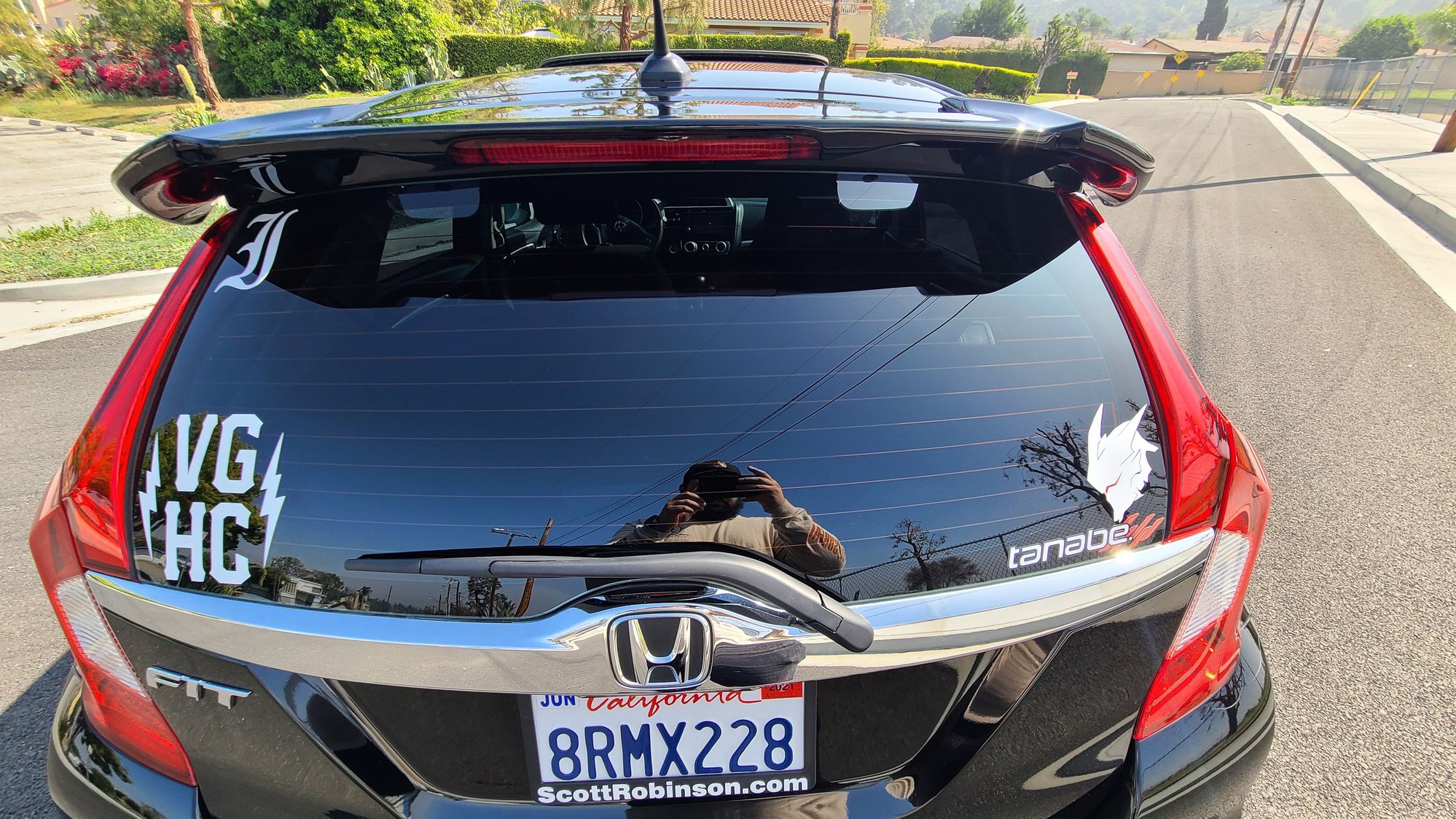

I was finally able to get a car wash and put on my decals. Small photoshoot to celebrate

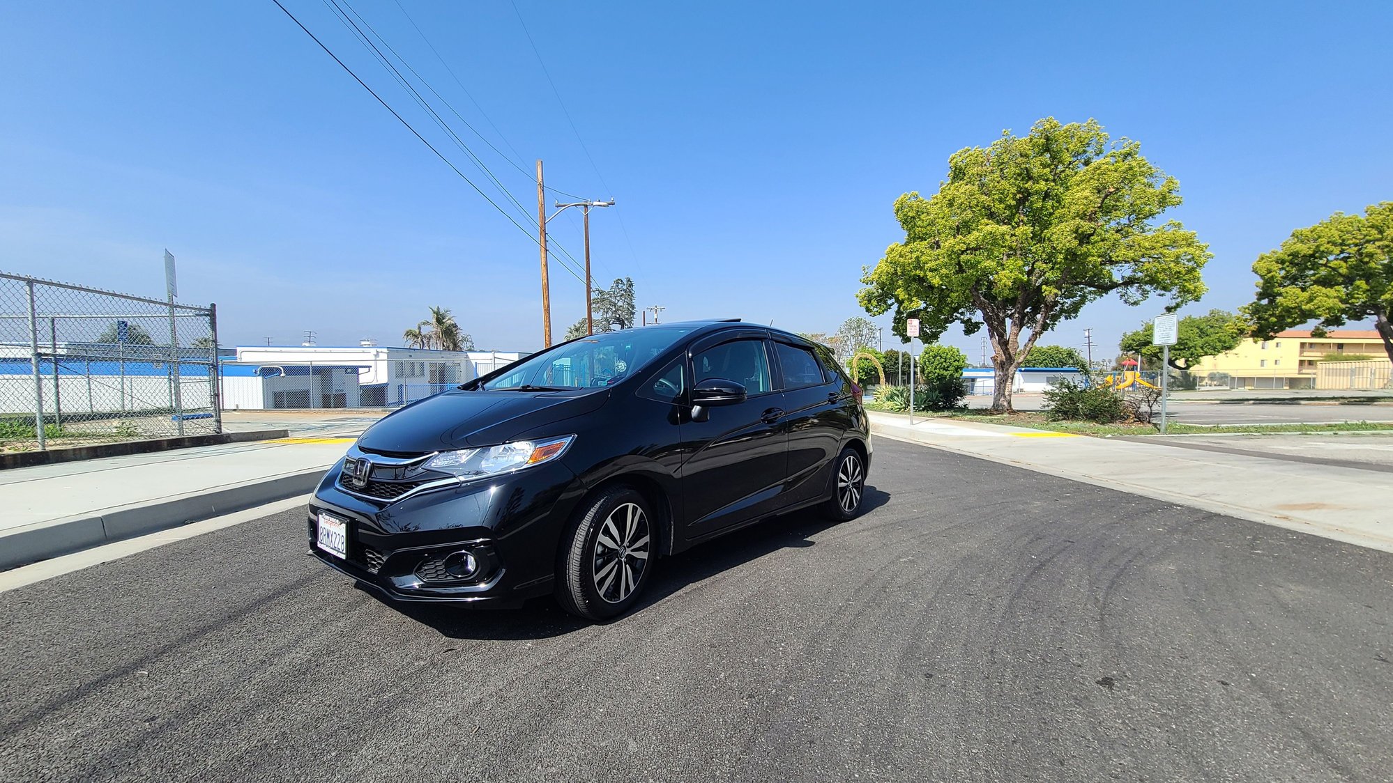

I was finally able to get the lowering springs installed and I love the way it looks.
It's not super aggressive, but it still has a sporty look to it. I went with the RS-R SuperDowns and I love it so far. Nearly identical feel after the first day, but we'll see in a week. Will take it back for alignment next Saturday, giving it about 500+miles or so.
All that's left for now is my lip kit and eventually finding some wheels to fill it out
The before
The after
Just over 2 fingers in the rear
And in the front.
