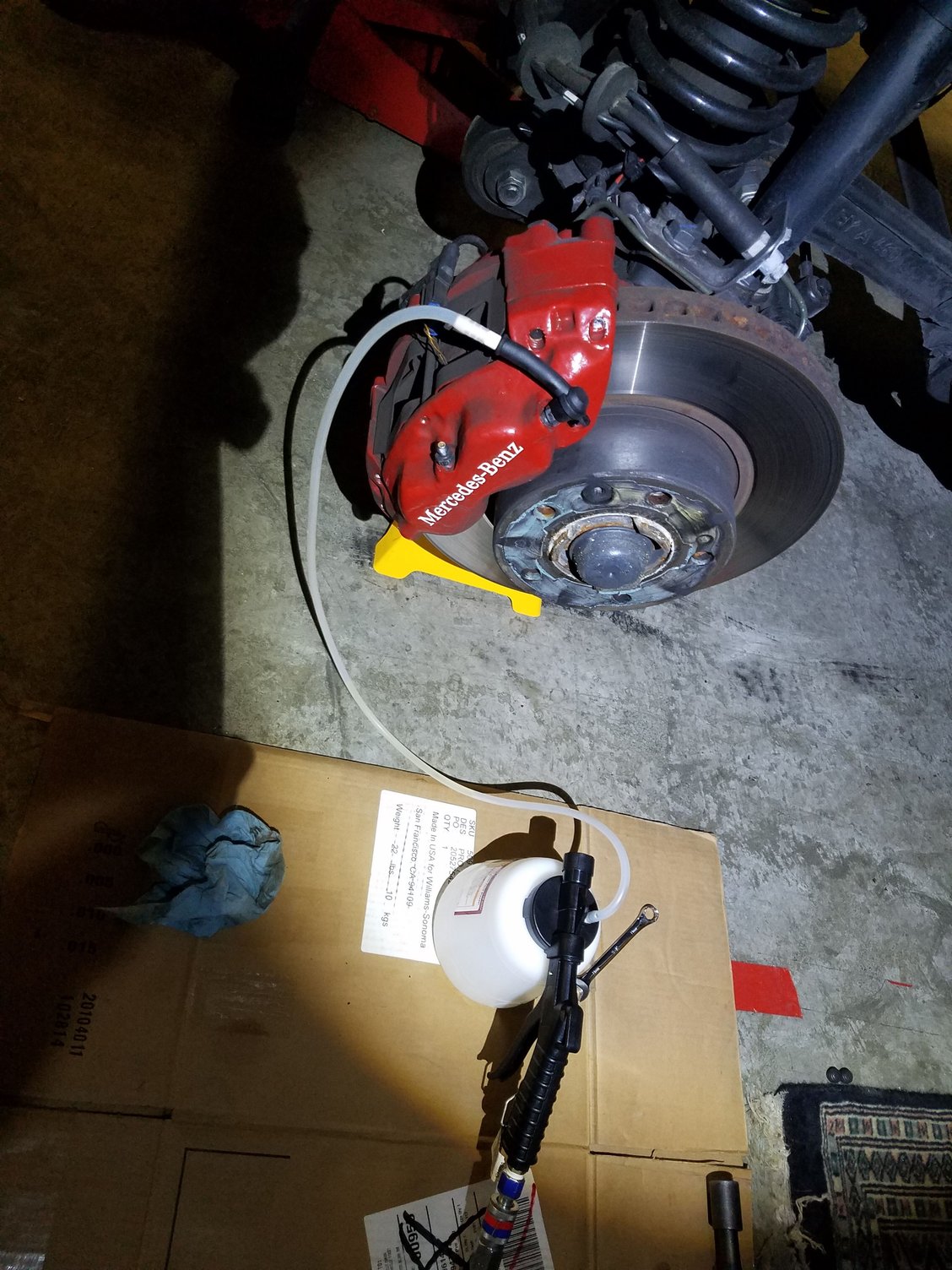

Wife's truck ready for brake bleeding.
Used a Speed bleeder
Made sure I had ample protection before removing the tires. Still too young to die from a DIY mistake!!! LOL!!!

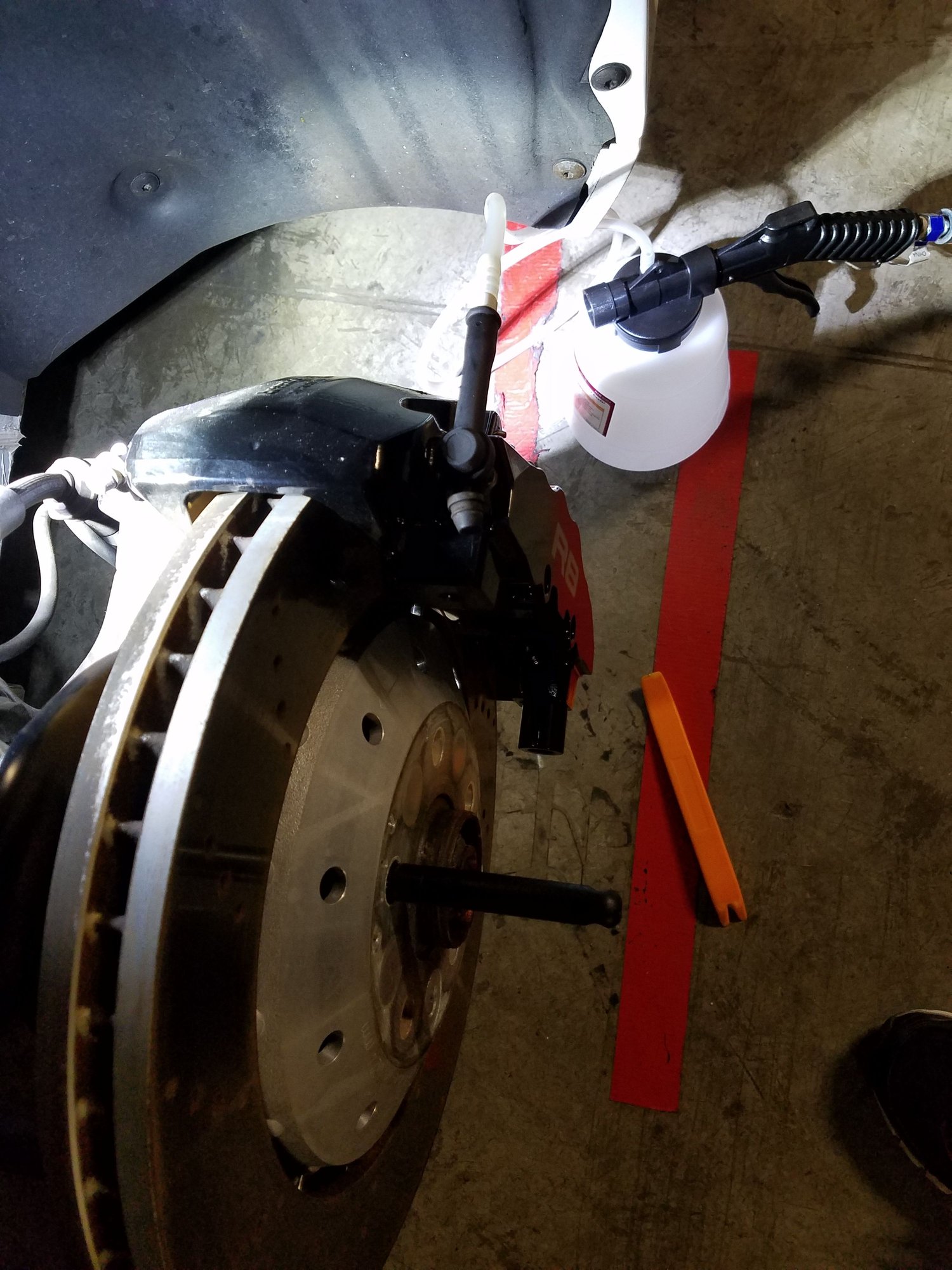

In the Audi, trim removal in trunk area as well as both wiper arm removal are necessary to access the brake fluid reservoir. Fantastic engineering design??? Bet that all dealer's service departments are loving this!!! They're charging only $400 in labor!!!
Used a speed bleeder and the required DOT 4 fluid.
Two bleeder valves on all the 4 calipers. Outer first then inner.
Its been two years since the last bleed. Old fluid (right) is still decent.
Finally installed the 20" OEM wheels with bolts properly torqued to 90 ft./lbs.. Am really liking the "newer" look!!!
