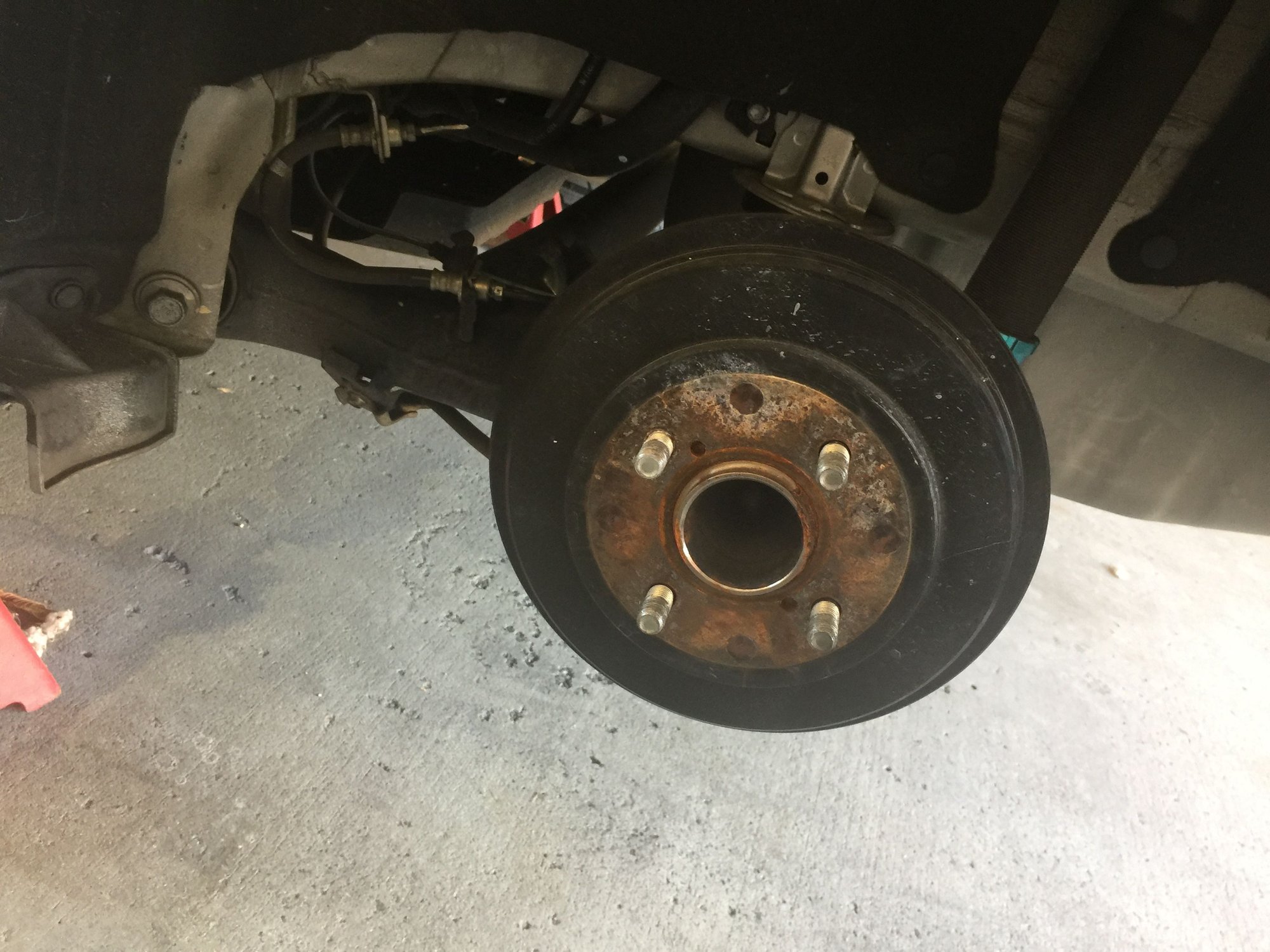

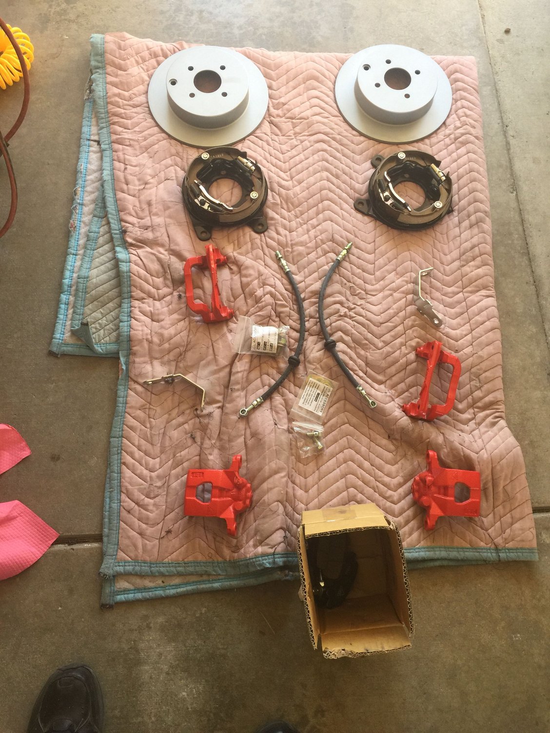

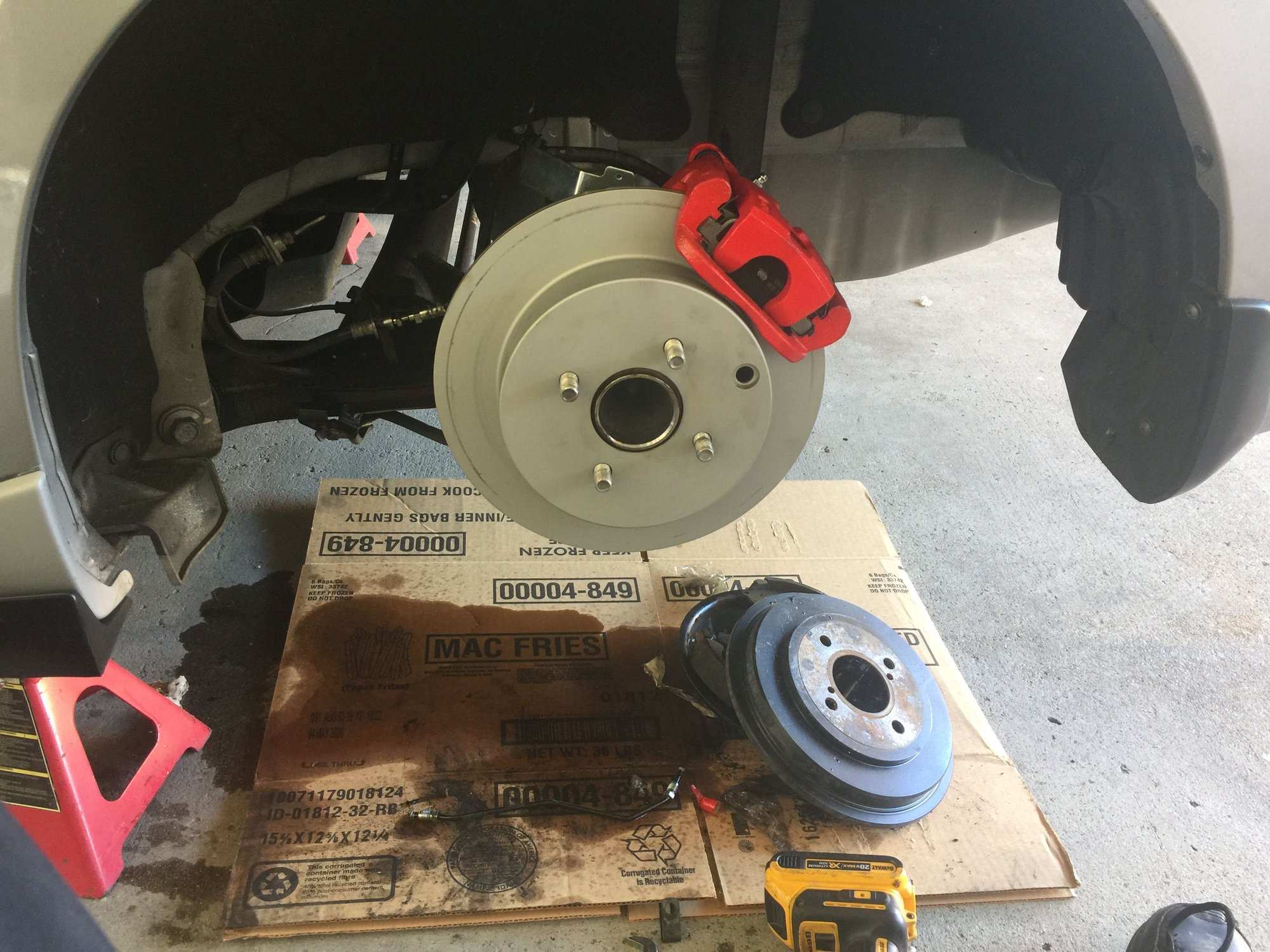

Rear brakes
Hello I have done the swap is great the kit has everything you need for swap
Oem
The kit
Putting in work
Swap complete
Ready for the test
The sexy fit let me know if any questions

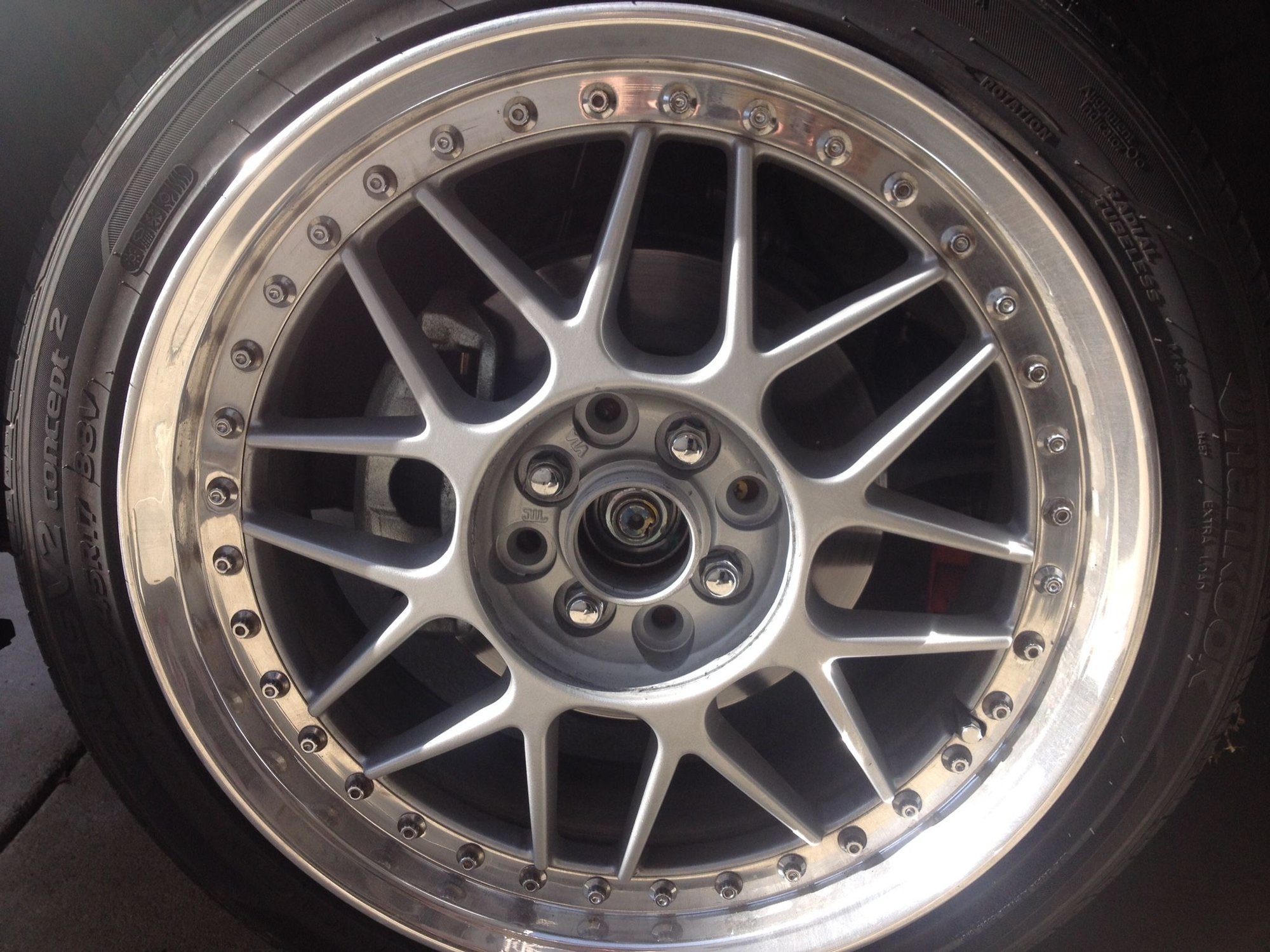

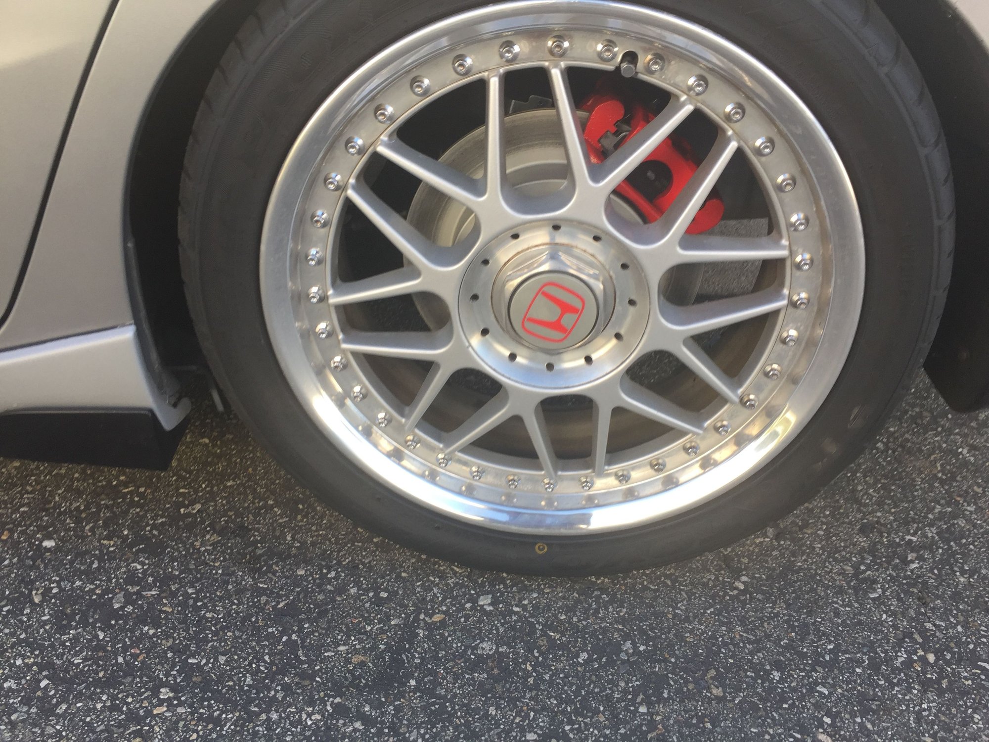

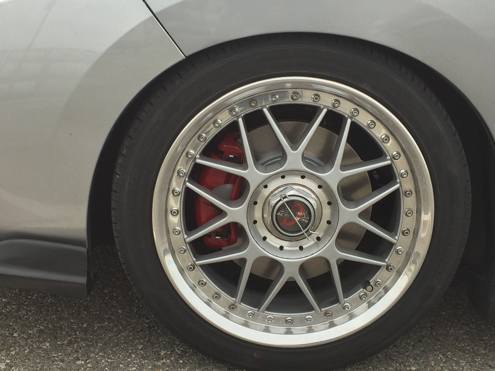

From bbk
Oem not to good
Oem 10” rotor Mini Cooper s 11.1 for the caliper and bracket I have a 2014 accord for the bigger rotor
This that you need
The rotor covers the wheel gap
This the finished product Let me know what you think

Originally Posted by Elpapas
Oem not to good
This that you need
Dude it came out great! I love the way it looks. I'm tempted now

Rear rotor
The rotor should be ok I have a Acura TL and the e brake is the same 149k miles rotor still ok
