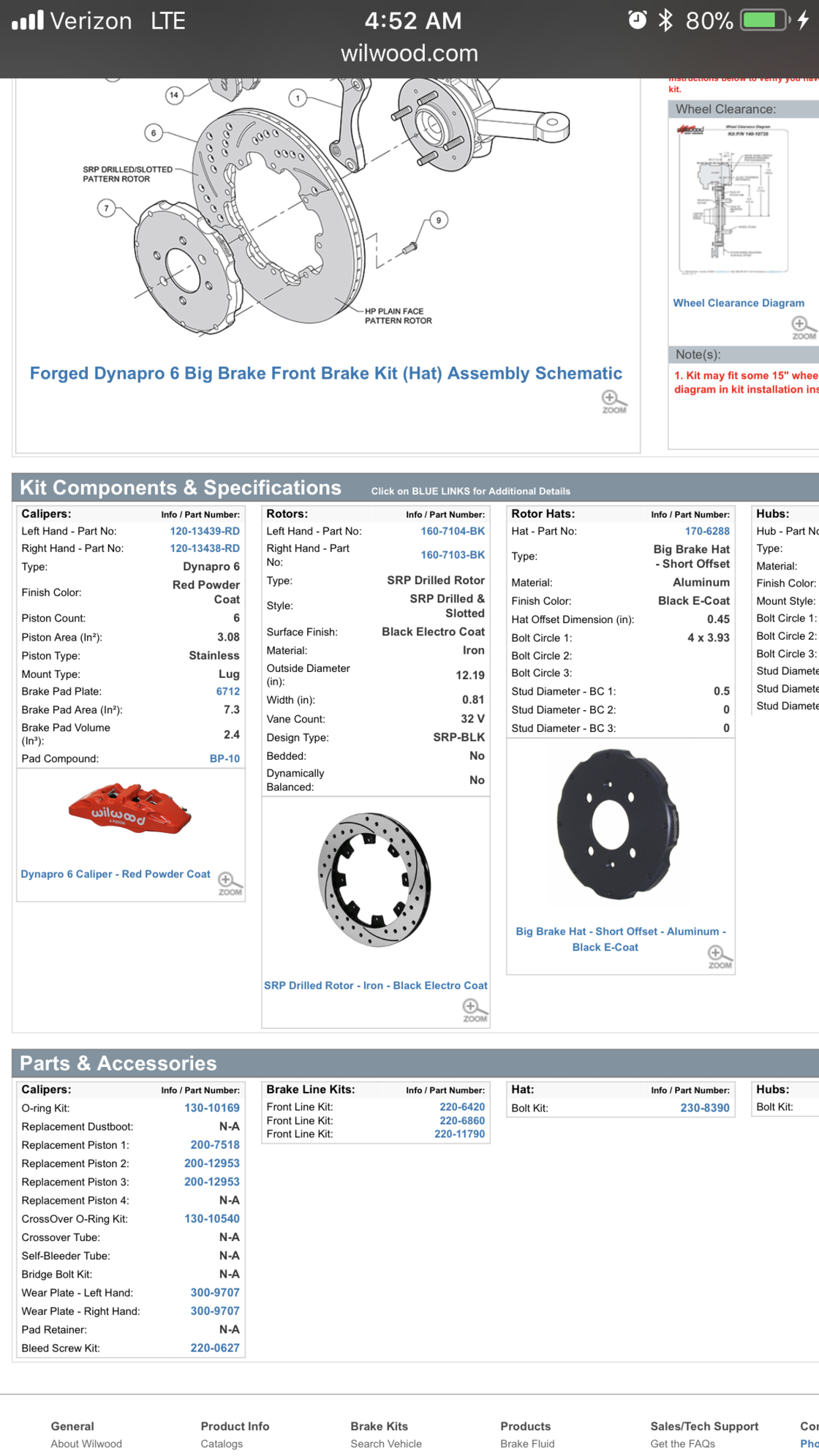

Thanks for replying USDM. The rotors come in the kit as USDM mentioned. They are the SRP drilled rotor. Here is a pic from Wilwoods website with part numbers.

Thanks for your post. Do you use any spacer? My rims probably interference with the calipers. Just wondering if willwood could offer other Hat with differenceHat Offset Dimension (in):0.45
