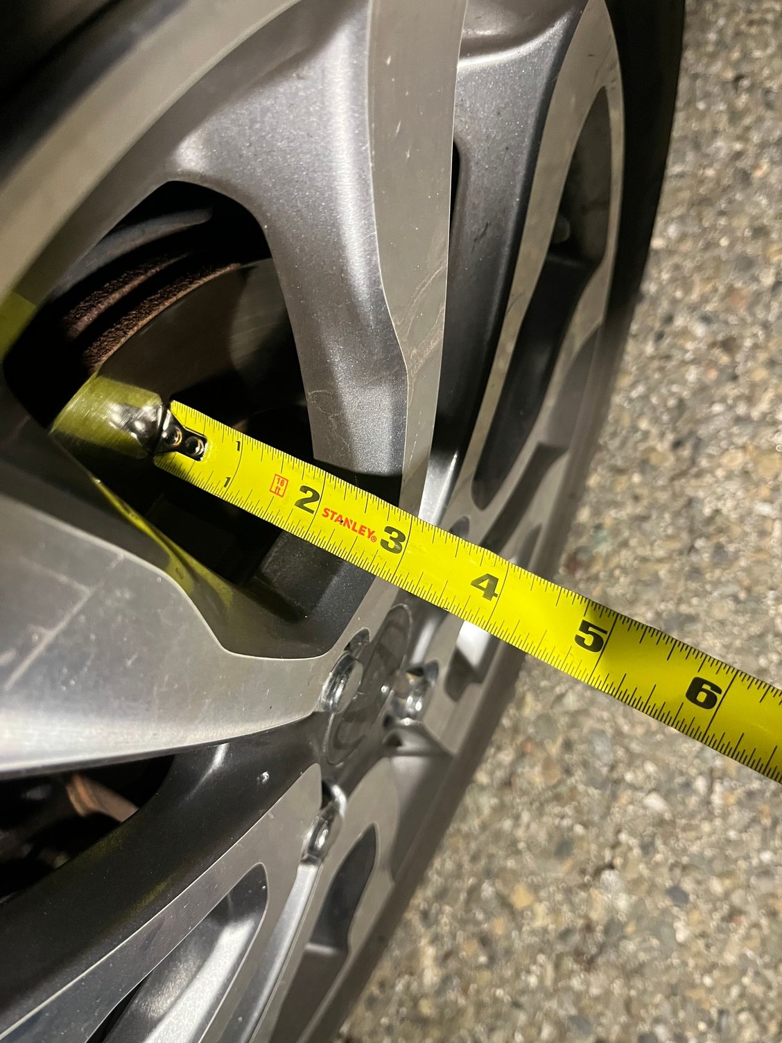

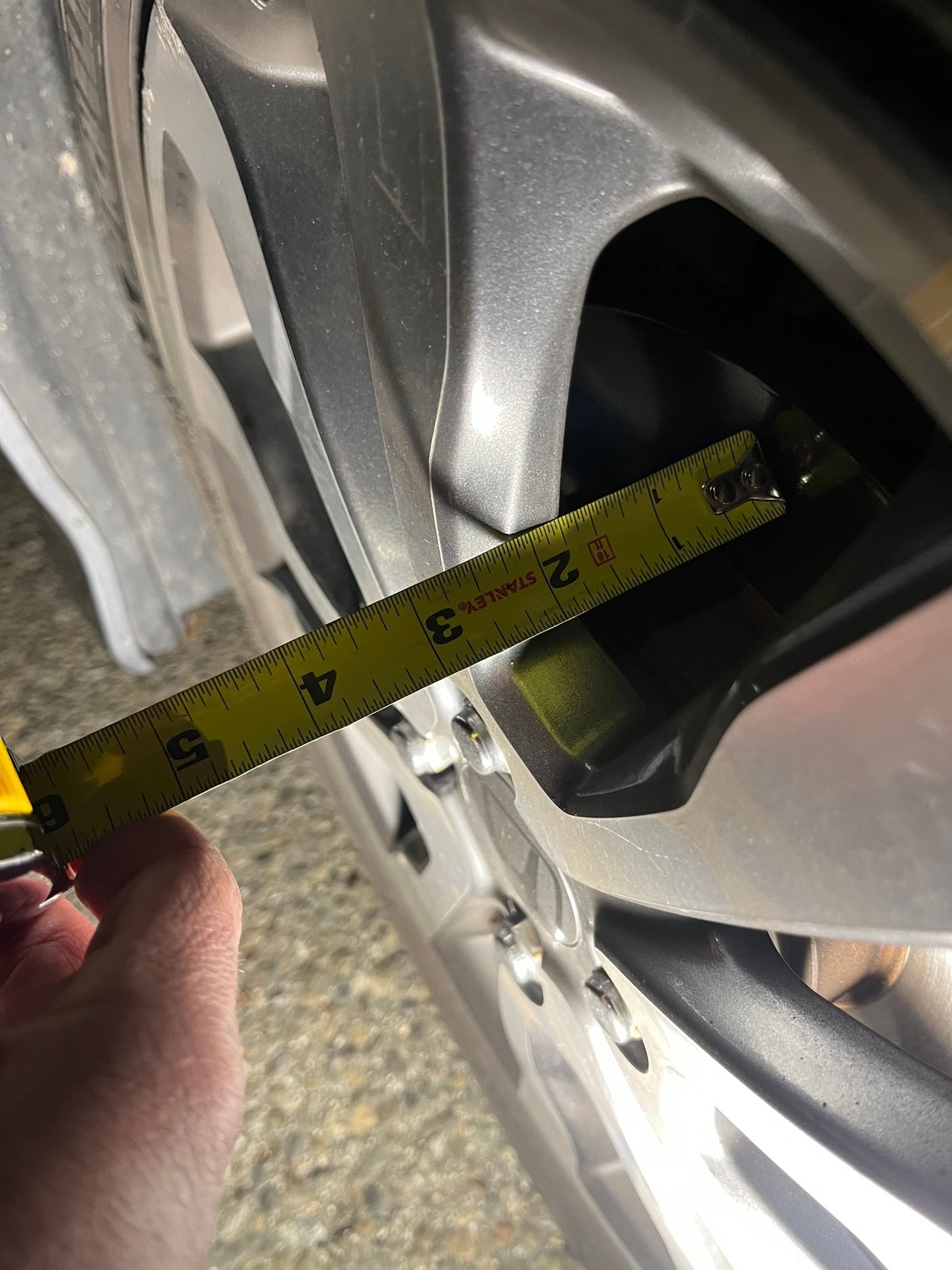

Does anyone know if the willwood calipers for the stock 10.2" rotors will clear the stock GE8 16" sport wheels? The diagram show a the caliper sticking out from the rotor where it meets with the wheel .840 I tried to measure the clearance on my wheels, but it's hard to say. I came up with what looks like 3/4"

My willwood brake kit showed up today. I'm still waiting on my stainless brake lines, but I figured I check and see if the stock 16" wheels clear the calipers. I attached the calipers to the mount and to my amazement there is 1/8" clearance between the wheel and the new calipers!
