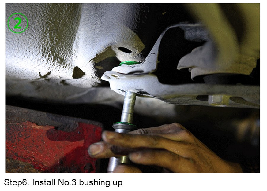

My buddy and I were able to tackle this install relatively easily. We didnt have a lift or much fancy equipment, but still able to finish in under 2 hours.
Rear collars were insane simple:
-jack up the rear end
-remove wheels
-before removing bolt, support with a jack
-unbolt bolt in question, slap on collar, and re tighten.
Fronts were not as simple as the rears, but not too tough:
-Jack up the front end
-Remove wheels
-Loosen all 4 bolts to allow some slack/movement of the subframe
-Install FRONT collars, top one first, then bottom one onto bolt. Insert bolt and hand tighten
-Install REAR collars next. Exactly as you did the FRONT collars. May need to remove a nearby bracket and bolt if more clearance is needed
-Tighten it all down with your impact gun, and marvel at your awesome ride
Using this graphic, we'll call position 3 "FRONT" and position 2 "REAR"
For those who own a lift and have a means to support the sub frame, my guess is the install is easy beyond easy. My install was on a driveway, we had to do 1 side at a time. That said, we did have to use a big friggin Pry Bar in order to create a gap to insert the upper collars:
FRONTS pry angle:
REARS pry angle:
Here is the hardware for the FRONTS and how the finished product should look:
Here is the hardware for the REARS and how the finished product should look:
Conclusion = HIGHLY RECOMMENDED. The diff in feel these little collars make is night and day!

here are the included (and horrible) instructions:
