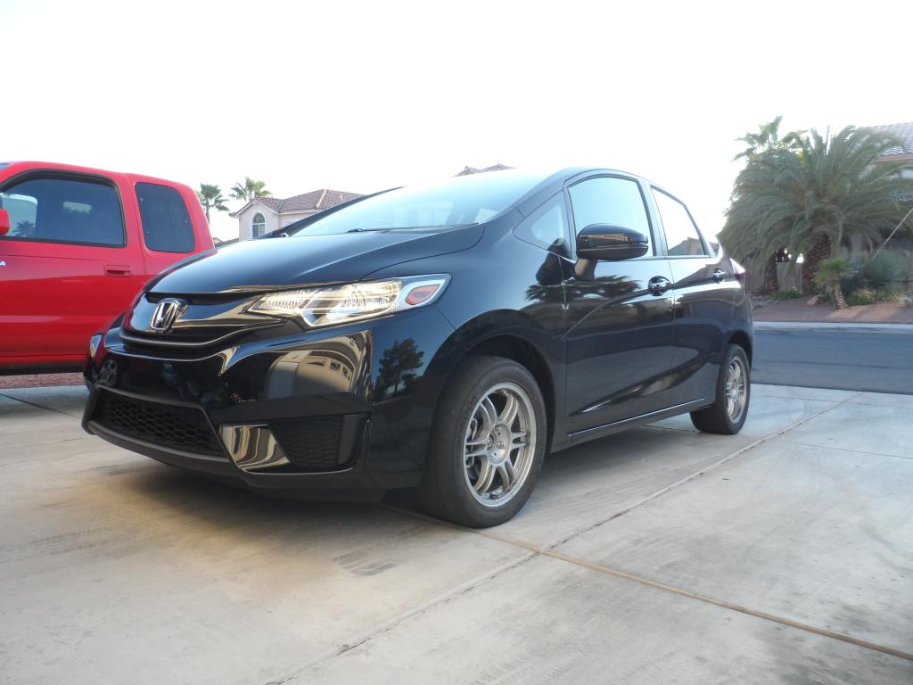

just for info for you guys, the wells of the 2015 have a lot of room. these are Kosei K1-TS 15 x 7 with a 38mm offset, and Hankook RS-3's in 225-45-15. they had plenty of room.
i did jack the lower control arms up in the corners to simulate a 2.5 inch suspension drop, and they still had the clearance to turn the front wheels lock to lock, and will have room for suspension travel when the car hits bumps. i would say that is you are crazy enough, you could fit a 245mm section width tire, and it will have clearance. they really do have big fender wells. but IMHO, a 205mm seems to be the perfect width for these cars.
i dont think a 16 inch wheel will have any problems fitting with the same offset either, assuming you keep the tire profile around the same diameter as stock.
no, these are not the wheels i am going to put on the car... these are from my 1989 Civic Si SCCA STC autocross car. you can read about why i put the wheels on the Fit in the newbies section.

Thanks for posting the pic, Daveds50. I put your wheel/tire specs in the online calculator, and yours are 1.1" shorter in diameter than the 205/50R16s I'll be using (which have virtually the same diameter as stock). My wheels are 16x7 +40 and should sit very similarly to how yours look. I'll post pics once the wheels get here and I get them mounted and installed.
es
just a note, don't trust the tire calculators. they assume that the tire measures exactly what the manufacturer claims. which, is rarely the case.
example: back in the day when the Falken Azenis RT-615 was the hot autocross tire in Street Touring classes, i bought a set of 205-50-15's. stuck them on a set of 7 inch wide wheels, and put them on the car. was wondering why i had so little clearance. took the wheel/tire, and measured it. 221mm wide section width, and was taller... but was true to the 50% of the 221mm width.
that has been the case since. almost all the hot tires i have used, including the RS-3's, have been oversized. if you ever saw a 225-50-13 Hoosier A6, you would wonder if it was designed as a 13 inch tire for a Corvette...
best to go to the manufacturers websites. most of the reputable tire companies give the exact actual specs of the tire. something that none of the calculators can do.
