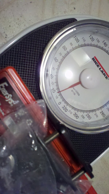

I also went back and dug through my records and photos... I overestimated a bit:
OEM battery tie down and tray weight = about 20lbs
PWJDM Kit and Oydssey = about 15lbs
So its more of a net 5 pounds saved. It does significantly open up the engine bay though and make working on the car a ton easier.
Later this year I may be going to an ULTRA lightweight LiFePO4 type battery from Shorai. Looking at a LFX18L1-BS12, 270 CCA - 2.19 lbs. That's will get me down to something like 15+ pounds of weight saved This should also help with corner balancing/cross weight of the vehicle once I'm on coilovers
