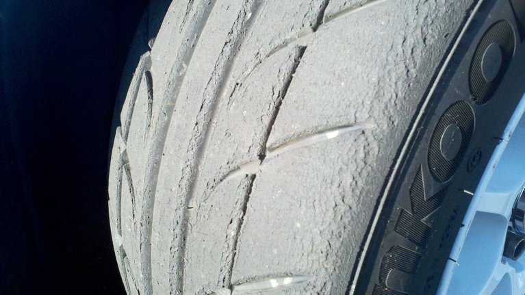

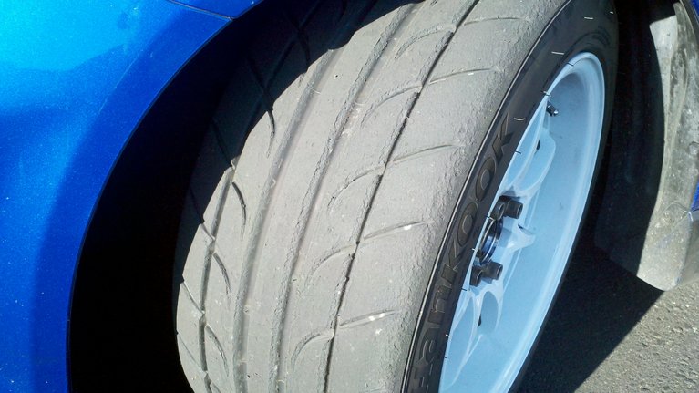

Having the rear PSI higher than the front did seem to make a marked difference in rotation at lower speeds for me in my GD. Not as much as the Progress RSB though
I think I will have to try a chalk test with my AutoX wheel's and tires before my next event on the 19th. If it seems that tire pressures need to go up, I will have to invest in a far more portable compressor than my 220v unit at home...
This is the wear I noticed after my last event running 30psi front and 32psi rear. I thought it was from excessive acceleration while cornering. What do you think?
