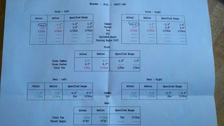

hmm, I have the print out from the last alignment around here somewhere... Here is what my last printout said:
looks like 3/32inch in the front L and R if i read that right?

that's good old chunkin... entry speeds may be a bit excessive...
the outside looks like its worse than the inside...?
