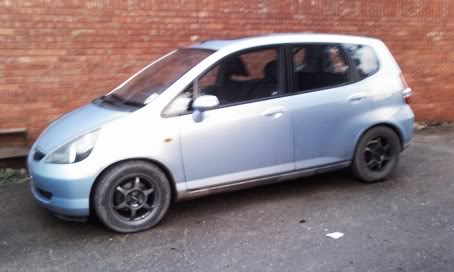

Current Pics (sorry if a lil' fuzzy, taken on my drive :P)
Before Drop -
After Drop -

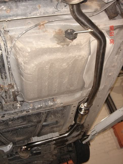

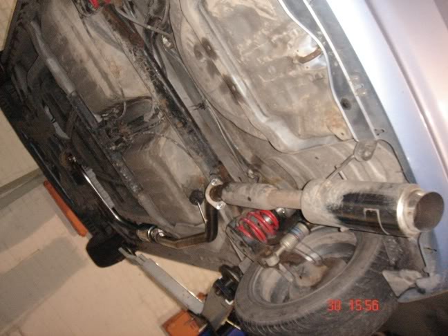

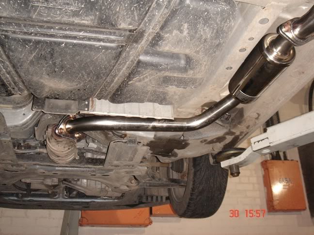

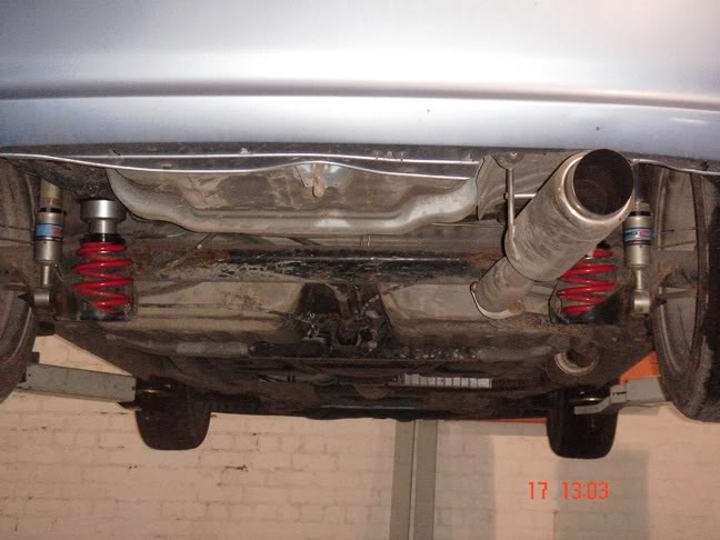

Here's a pic of the underside of my car.. it needs bit of a clean i think!

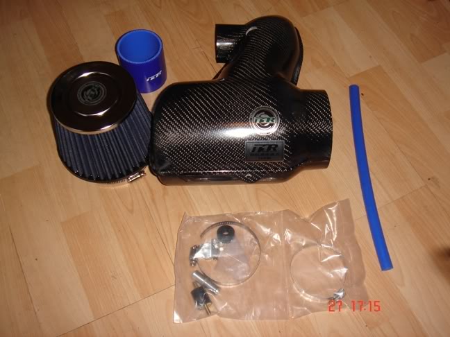

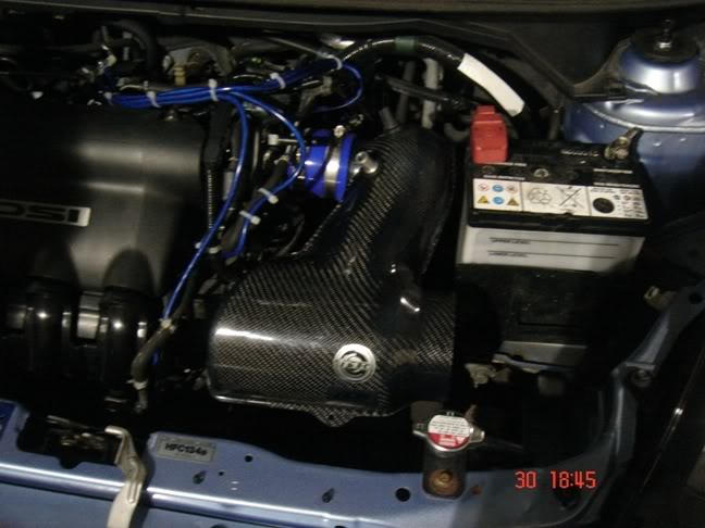

Got my B-Pipe and Intake fitted... and what a difference it has made!! It is much more responsive than it was before as well as sounding much more louder and fierce... and i love it
All in all took around 6hours to fit, as it was a bitch to take off the old B-Pipe due to corroded bolts etc.. as well as to modify the new B-Pipe as that wouldn't fit on correctly... the intake was pretty straight forward.

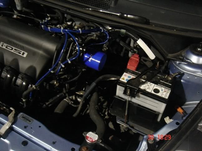

Engine bay with the stock airbox taken out.
A tight fit, with having to modify the battery tray to get the intake in.. but got it in the end.
PS. I also have a Progress Rear Anti-Sway Bar... which does not fit even if it was tried using different angles. Guess there's some variation between the JDM model and EDM.
Fitting in reverse is alsno not possible as the bar hits the spare wheel well.
