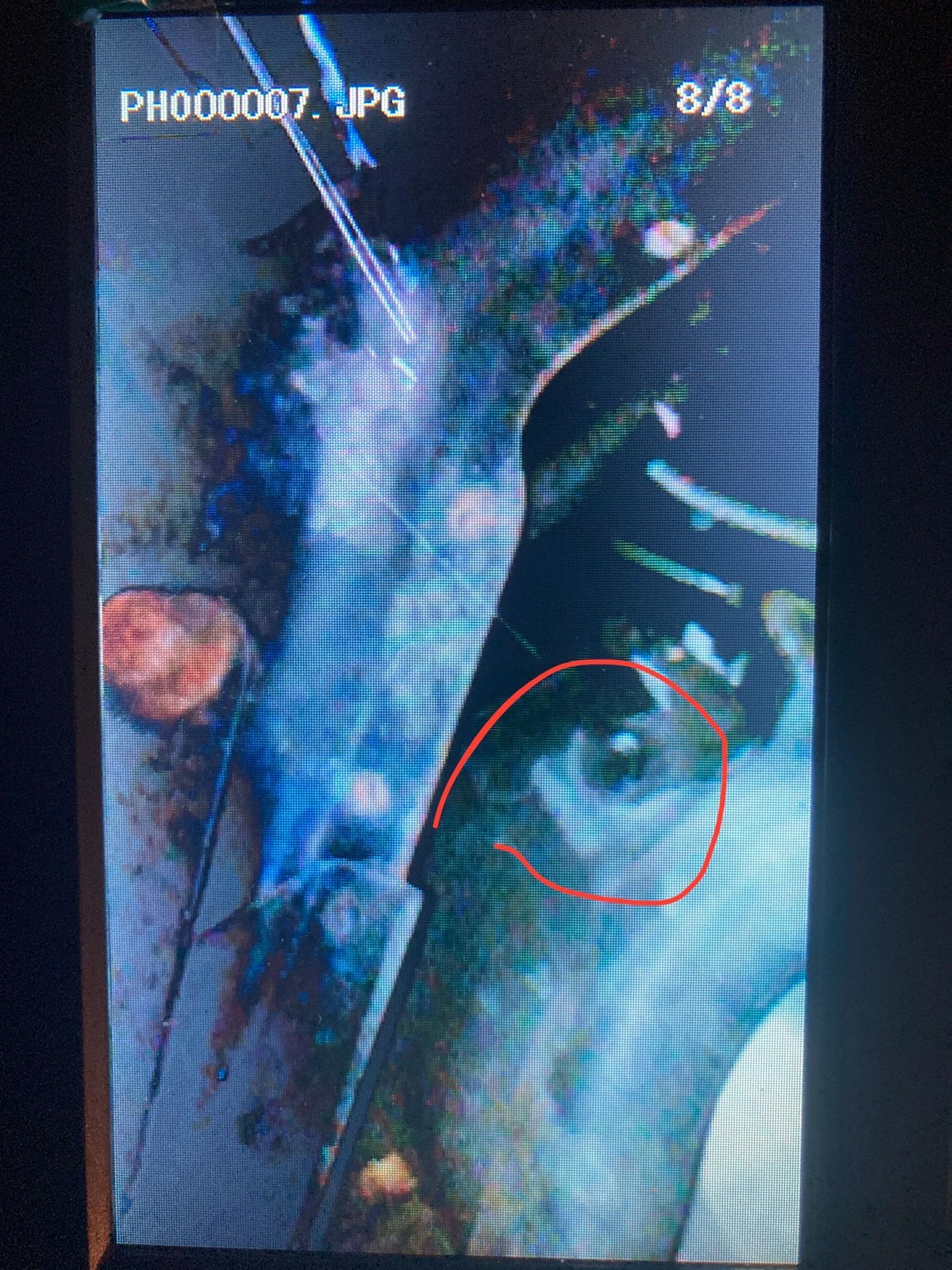

Title. Is this condensate from the air conditioner? Something else?

Were you running the A/C? If so, it's most likely water from the drain, and it's the right spot for that as well.
Move the car and see if it looks, feels, and smells like water. Oil and transmission fluids will have color and lubricity, coolant and windshield washer fluid are generally colored, gas smells like... gas). If you're willing you could always taste to confirm.
As a further confirmation, see if the drip corresponds to whether you have the A/C on or not.

Update - 99% sure it's just water from the A/C. Caught some in a baggy, it's crystal clean and no smell. And it looks to be coming out of a port that's meant for this.
