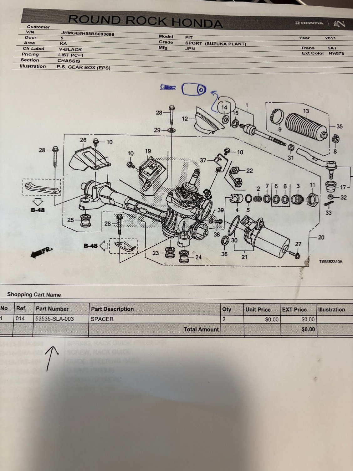

Hello!
I have a 2011 honda fit and I am replacing the tie rods, after removing the inner tie rod I noticed there is a plastic spacer which is broken in my car.
You can see the plastic spacer in this video, look at 3:52 timestamp
I went to the dealership and they can not find the part number.
Questions:
1-Do you guys know by any chance the part number?
2-Is there any workarounds for this problem?
3-Can I install the tie rods without the plastic spacer?
I have attached a picture of the schema and the part should be on the left of part #14 but it is not reflected there.
Thank you, any help is appreciated!!

I’m in the same pickle.
While removing the inner tie rod i crimped the plastic spacer. It’s still tact, but it got squeezed and slightly cut. Can i just keep using it or am i asking for trouble?
