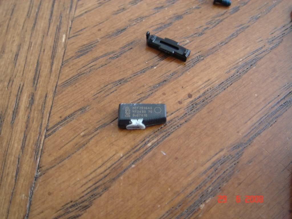

Here is the one difference. My OEM Immobilizer chip is identical to the one in the Acura TL FOB so no modification was needed when I switched them out. I am not sure if all 08’s will be like this or if it is a hit and miss. But it made the process that much more easier:

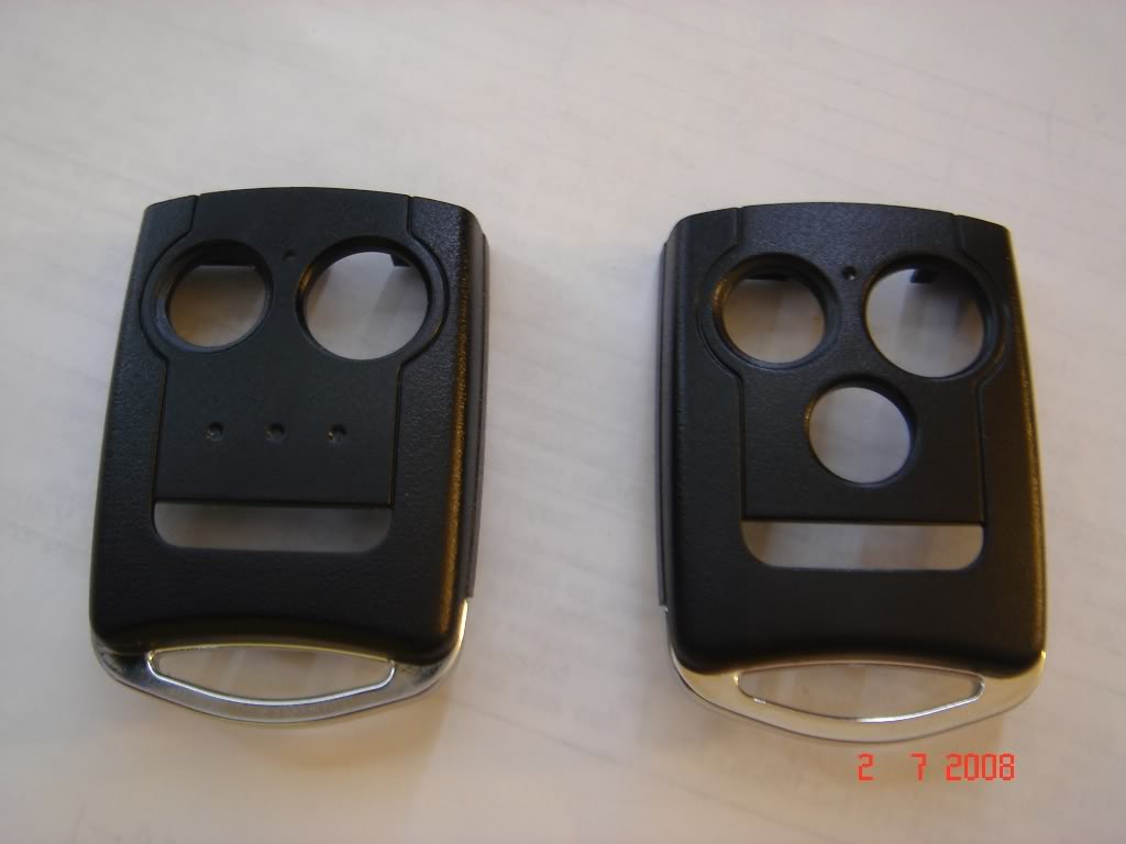

RDX face plate vs. TL face plate pic:

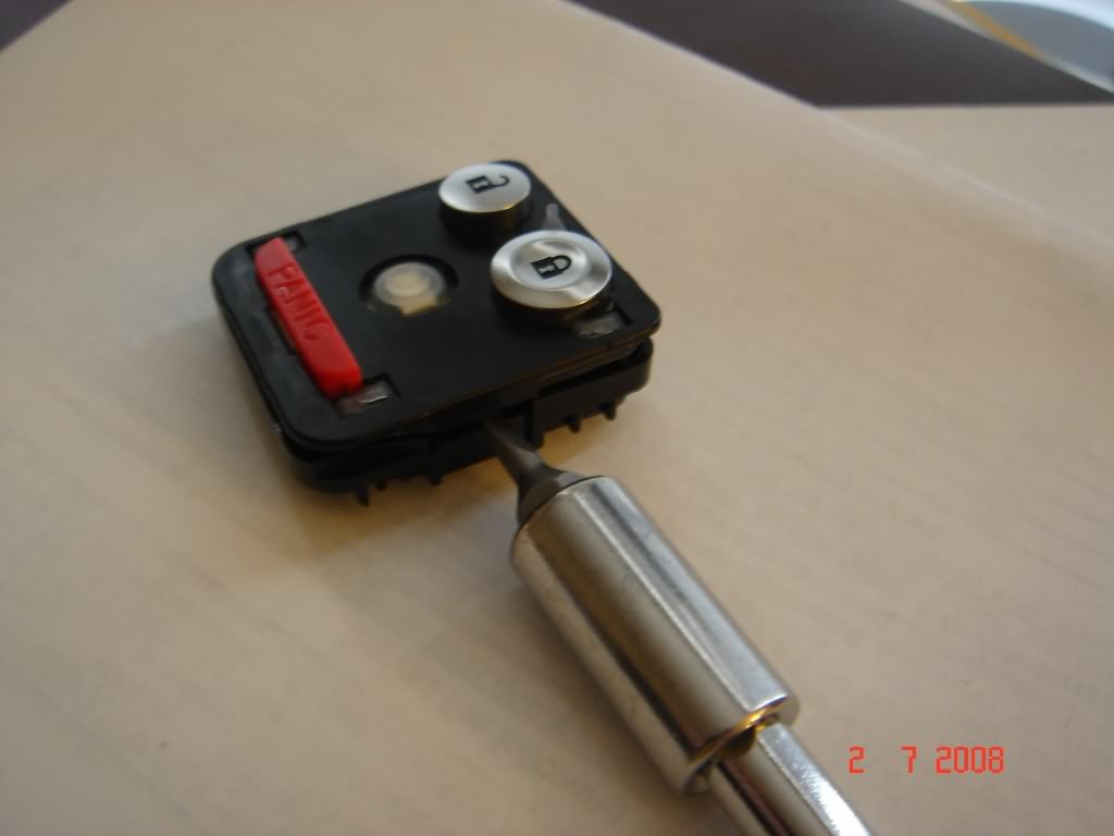

First step is to open the part with the buttons. Just use a flat head screwdriver to pry it open like in the pic:

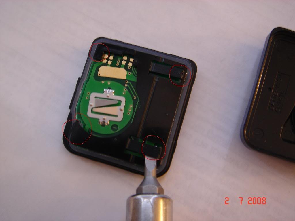

Next you need to pop the tabs that will give you access to the button assembly. This too can be done with a small flat head screw diver. At the 4 points shown in the pic:

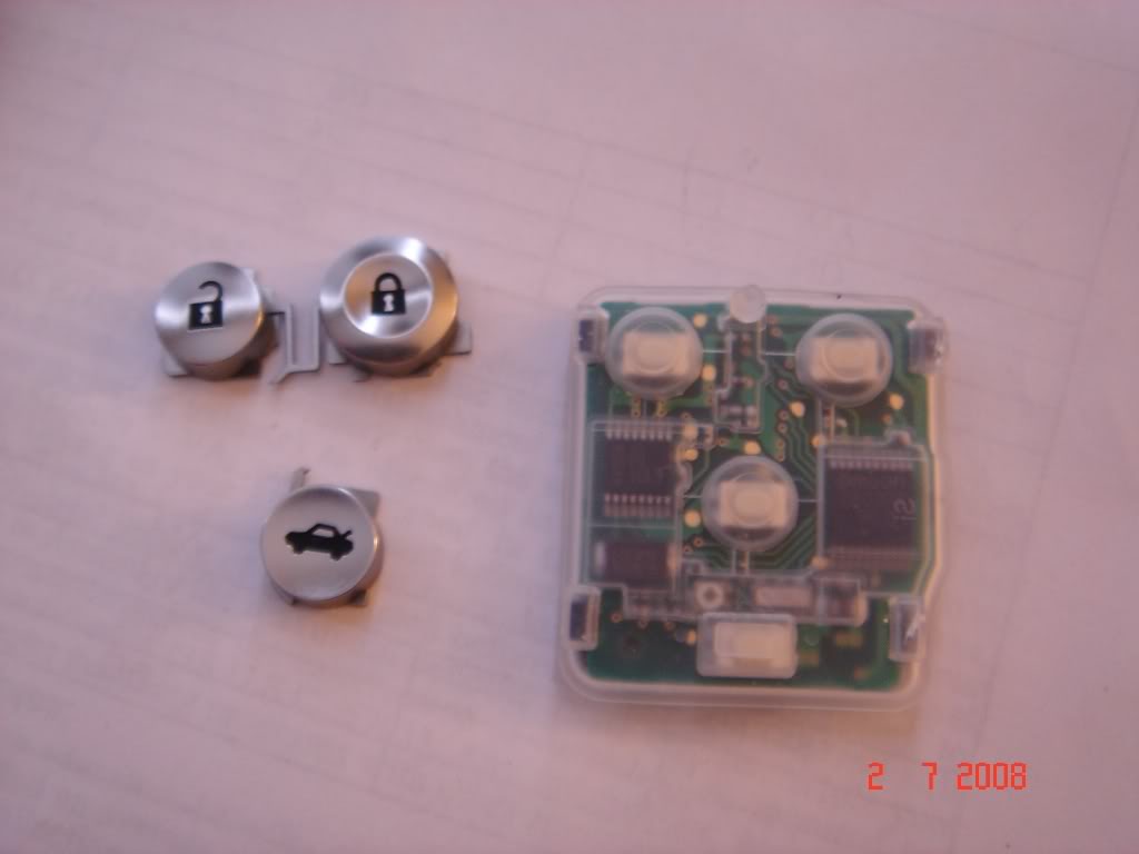

Now cut the trunk release button off as shown in pic:
