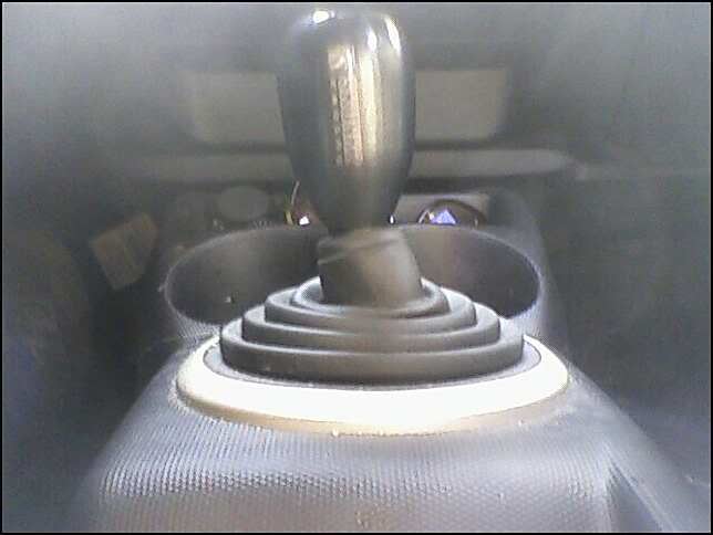

here is something if you want a short throw.

i just pulled the stock lever out and cut off 3.5 inches and welded the threaded end by the dog leg in the lever. now the know only moves about 1 inch from each shift. i have skunk2 knob and short shift mounts.
i spy kelsodeez old spoon knob in the arc ox on the floor.

wow both look really nice
