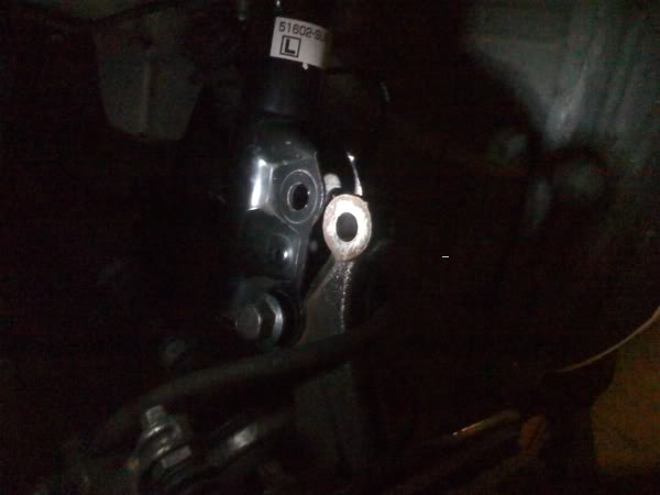

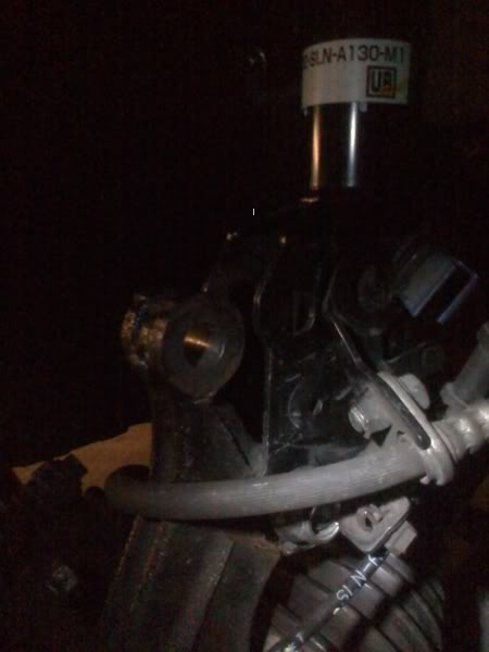

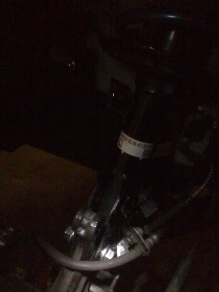

I can't seem to get the knuckle to align to the Shock Tower

Has anyone had this problem other than me? If so... what did you guys do?

I'm hearing my axles may have popped out... How do you know if they have or have not? LOL

I used another jack under the knuckle to raise the knuckle in place. Lets hope your axle is not popped not.

I've been hearing over and over again that it is so... I'm screwed because it's my daily driver

Feel at the end of the axle, there is a boot. If the axle popped out, you may be able to guide it back it by twisting the hub with one hand and guiding it back in with you other hand by feeling through the rubber boot.
