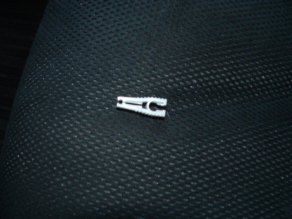

Just got a new Fit. Getting ready for RV touring and will be towing the Fit. I need to pull the radio fuse. Found the fuse, but cannot find the fuse puller. The manual says the fuse puller is located under the fuse box cover located in the engine compartment. Found the fuse box cover and removed it...no fuse puller. Anyone run into the same issue? Discovered where they hid it?

It's white....it is installed as a fuse cover to protect the back-up fuse...look for something like a weird looking fuse

on the GE 09 it is the white square on lower right beside the red #10 fuse. Just squeeze the ends and pull it out. This is the box under the dash not hood.
Black3sr is Correct!
I just ran out there and snapped a couple pics for you.
Pull here. Don't be shy.

The Orange plastic bit over the top left hand corner is just a protector for the back-up fuse. The one for the ECM and Radio. The puller is in the red square with arrow.
Just like Black3sr said squeeze and remove....Voila!
