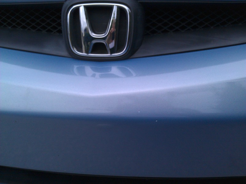

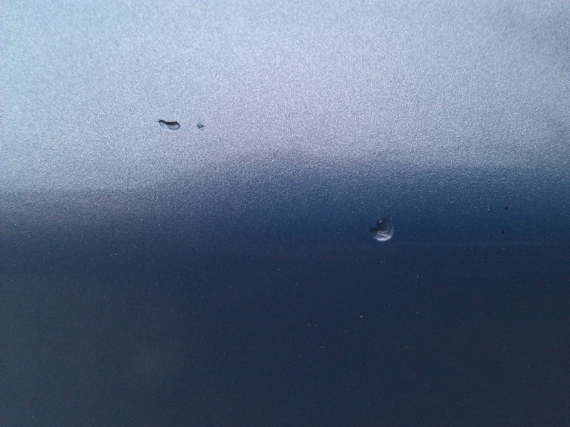

so i've got an '08 fit. bought her just a few days ago and, wouldn't you know it, i've already got a couple of tiny digs/gouges in my front bumper. i had the car parked at work and the jack-asses on the grounds crew were mowing... well they decided to mow right up next to the parking lot and blew grass all over my bumper/hood/windshield. must've shot a few stones into my bumper.
i have two small digs/gouges dead center in my bumper, just below the honda emblem in the grille. i'm wondering what the best DIY fix would be to remove these eyesores? i've been looking into something like dr. color chip, but i'm not sure if that's going to do the trick. these aren't paint chips. there is actually a very tiny bit of material gouged out of the bumper. would it be advisable to just do a whole bunch of very thin coats of touch up to fill them in? if so, then i think i will go with the dr. color chip. but if there's a better alternative, i'm all ears.
i'm so sad to see her already boogered up. other than the recent trauma, she's in immaculate shape for a nearly 5 year old vehicle!

Be prepared to fill the hole with paint several times. Once you get a "mound" of paint that is higher than the surrounding surface, let it dry for two months. (I'm not kidding)
THEN, use a standard wet-sanding technique to level the new paint. If the color match is good, the repair will be nearly invisible.

i dont know about langka how deep it can handle, but dr.colorchip will not work very well on deep indentations like that. best might be to keep adding touchup until you get a slight convex and sand it down after at least a month using a wetsanding block 2000grit+

I've used Langka and Dr Color Chip products. Both are good (but it takes a LOT of material)
They both rely on the Fill-The-Chip-And-Level approach. They use chemicals to smooth the paint rather than sanding. Just be patient, and apply MANY thin coats. Key Watchword is, Let it dry a while as I said, THEN level the "bump".

Any good OEM paint will fill the depression. To get a good paint match, I suggest Paintscratch.com Touch Up Paint from PaintScratch.com
They give you a test-card with each order, so you can test if the paint matches. If it doesn't, they will try again NO CHARGE. I'm a satisfied customer.

^^^ with modern clear-coat paints, yes you should buy some clear to mix into the matched color you buy. The color coat itself would not have as much gloss as a clear-coat finish.
Mix a small quantity of each in the paper condiment cups used to hold ketchup in McDonalds or the like.
Most factory touch-up bottles are actually a mixture of color and clear. And THAT'S why they don't seem to match as well IMO.

Don't sweat it so much about a couple little chips. A bottle of touch up from the dealer applied with a "toothpick" will work just fine. If you try to use the brush inthe bottle it will be too much and you will need to wipe it off and try again.
