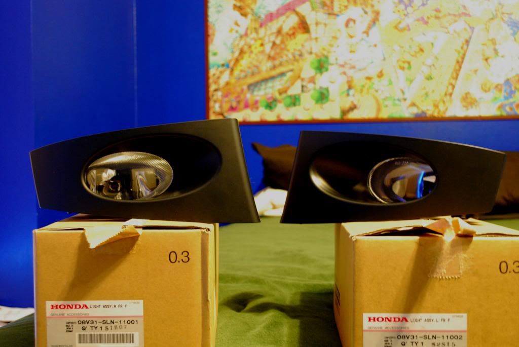

Hi guys, I installed some GD Base fog lights the other day on my GD Sport. The reason I went with the Base assemblies opposed to getting the Sport replacement assemblies is due to sheer costs.
Please note: Neither I or FitFreak.net will be responsible for any mishaps, damages, injuries, etc. occurred during this D.I.Y. Proceed this simple D.I.Y. at your own risk.
MSRP for one Sport fog light is about $225.xx to $243.xx depending on color and dealer/part site opposed the MSRP of $128.xx for one Base fog light. During the process of installing, I also removed the fog light lens from the housing itself to cover it in Lamin-X film.
Part Numbers:
08V31-SLN-11001 - FIT BASE FOGLIGHT ASSY., RIGHT
08V31-SLN-11002 - FIT BASE FOGLIGHT ASSY., LEFT

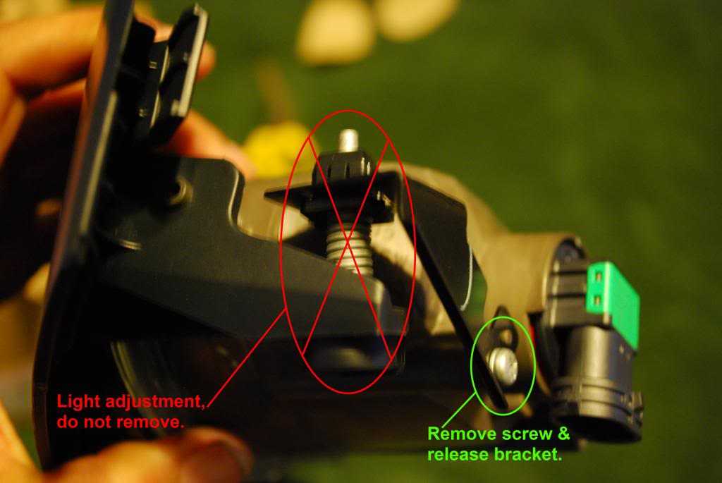

If you haven't removed your factory fog light assemblies yet, you will need a 10mm socket to remove the one screw securing it to the front bumper. In addition to that if you haven't removed the housing yet, you will need to disconnect the connecter for the fog light bulbs themselves.

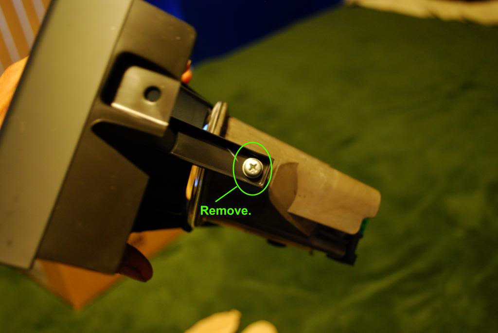

To remove the fog light lenses from their housings you will need a Phillips screw driver with a PH1 tip. And only 2 screws will need to be removed.
You will need to remove this screw, which secures the lens to the housing.

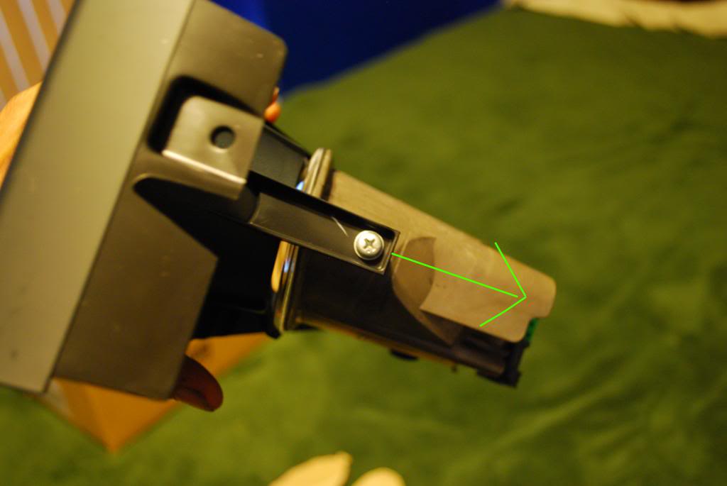

And also remove this screw, which secures the light adjustment bracket to the back of the fog light lens. After removing the screw, pop the light adjustment bracket off.
Note: DO NOT LOOSEN/TIGHTEN the screw surrounded by the spring (Circled and X'ed in red) at this time. That is for adjusting the fog light aim.
At this point, the lens is ready for removal. With the screw out, pull the lens out of the housing. Note: There is a guide pin in the housing, so you may need to move the lens up or down as you are pulling it from the housing.

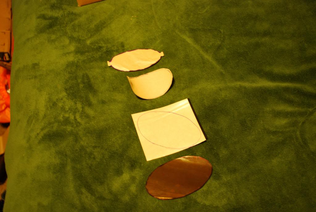

Once the housing is out, now would be a good time to put a protective film over it if you have some. I had a 25 foot roll of smoked Lamin-X film laying around and decided to put it to use.
For those interested in picking up some protective film like this, these are sold either by the sheet, roll and even pre-cut. If you get them pre-cut, it would be wise to install them with the housing on so you can accurately cover the exposed areas of your fog lens.
I happened to have the backing paper from a pre-cut, so I used it to make a larger stencil. (Then later discarded the stencil and "trimmed" 5 inch squares to fit the lens

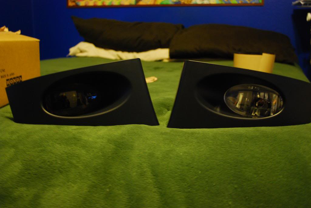

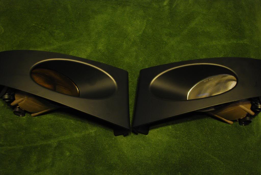

And here is the result of one Base fog light with smoked film in comparison to a unprotected/stock Base fog light.
