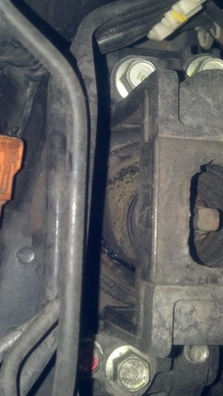

i have a bad motor mount, problem is that i cant find the replacement part. i have searched rockauto.com, autozone, napa o'reilys. I find 2 types of mounts but niether one looks like the one i need. am i missing something? here are pics of the bad mount

you can see the cracked rubber in this pic

Put a jack under the car, and remove the mount. Go to a parts store, buy whats called "window weld"
Fill your mount, duct tape the bottom when rotated, fill (liquid) and let set for 24 hours.
Mount repair!!

Probably best to get an OEM mount from Honda. A lot of the aftermarket mounts i'm seeing are cheap China crap with soft rubber.
