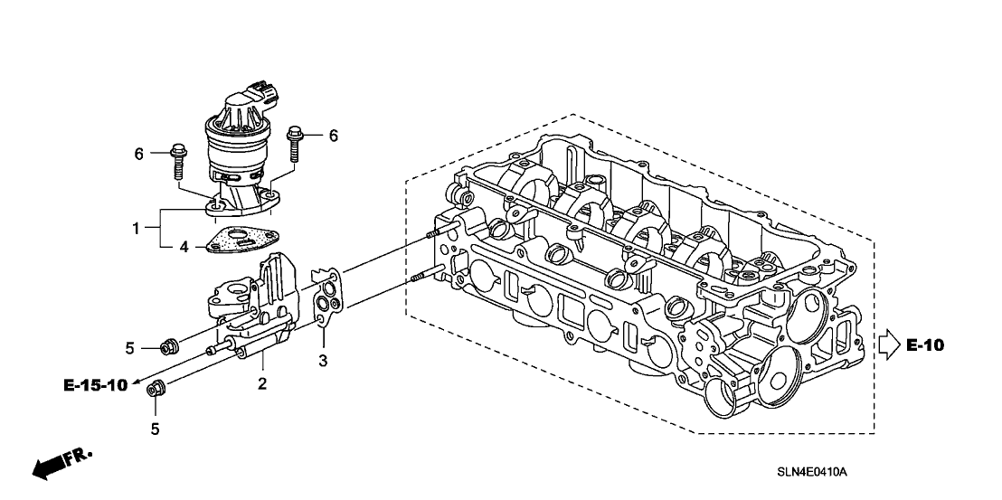

Pretty good, about 90% of the misfire is gone, i think the rest must be from the EGR valve. From the observation, I think i can conclude the following:
1) If you experience random misfire, then the problem is from the coil pack
2) If you experience misfire under-load, then the problem is probably from the EGR valve stuck open and/or cannot close properly.
right now I still have minor misfire if:
1) I put the car in D and hold brake, it would give a misfire sometimes, but putting it in N won't.
2) If I accelerate with heavy load, say going at 100km/h on 5th gear at 2000 rpm, and i step on the gas (without getting it to downshift), then it would misfire/stutter. However, if i downshift it to 4th and accelerate it from ~3000 rpm (lighter load) then it would run fine.
I've been driving with this workaround for now, basically just keep the load very light, even when i accelerate on highway, i had to keep it at 10-15% throttle to keep it from potential misfiring. But all the random misfire (it was almost undrivable before the fix) is gone now.
I tried to take the EGR valve out, but i couldn't fit my socket in there to loosen the inner bolt, and since I already stored my summer car, I don't wanna drive the Fit in and remove the little block that is attached to the EGR as the coolant will come gushing out...
I've also inspected my EGR passage (on the IM) and it wasn't blocked. so that's where I am at now. I just need to drive it lightly til spring come and also clean the EGR. that should get rid of all the misfire. at least it is drivable now. I need to commute 100km a day with the Fit.

The procedure should be draining the radiator, then remove the block that is right under the EGR. Unless you have some magic ratchet that can fit in there and remove that bolt somehow. I know none of my wrenches could fit in there, even if i can fit it in, i can't turn. I know coolant is going through it, because i unplugged one of the hose and coolant came gushing out lmfao.
Mine is about 180k km, when it misfire it doesn't throw CEL, UNLESS, i floor it and it have consecutive misfire, then CEL will flash, but it won't stay on. So i can't floor my Fit for the time being... anything below 4k rpm is still fine though. Before my fix, it even had a hard time below 4k, it just kept giving random misfire here and there.
The price of replacing the EGR is about $400... I know because i just asked last week lol, and that's not even from the dealer. I was like, screw that, i will fix it by cleaning it up next year in spring...
