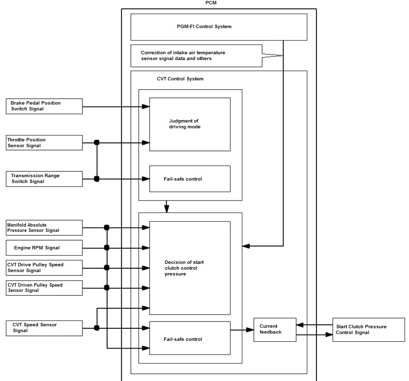

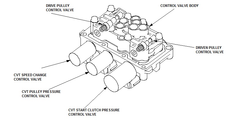

Could the problem be the Starting Clutch that is dead ?
or a bad sensor ?
this is a diagram that i found
and i will try to clean this
Attached Thumbnails CVT Gearbox not moving-123734saa2e02e15100000000caad09.png   CVT Gearbox not moving-157019saa2e02e15100000000caad12.png   CVT Gearbox not moving-581786diag.jpg   CVT Gearbox not moving-281230valve.jpg
Old Feb 19, 2016 | 06:19 PM
dwtaylorpdx's Avatar
Joined: Oct 2015
Posts: 1,465
From: Portland Or
Not 100% sure, but I believe when they say "clutch: they are talking about the action of or the way the pulley starts the process of squeezing the belt/chain to start the car forward, its not a traditional clutch mechanism. Whats interesting is I don't see a reverse valve on that thing, Does the CVT use a aux transmission to change directions? Like a internal mini gearbox that puts a planetary in and out of gear, I haven't found a good exploded diagram of the Honda CVT yet.

i think the best cvt description of the cvt of honda fit can be found in this page :
CVT System Description (CVT)
the sensor that i have changed yesterday was wrong, i have put a sensor of the civic.
i will also ispect the ignitions coils, maybe i have a misfiring problems
what do you think ?
