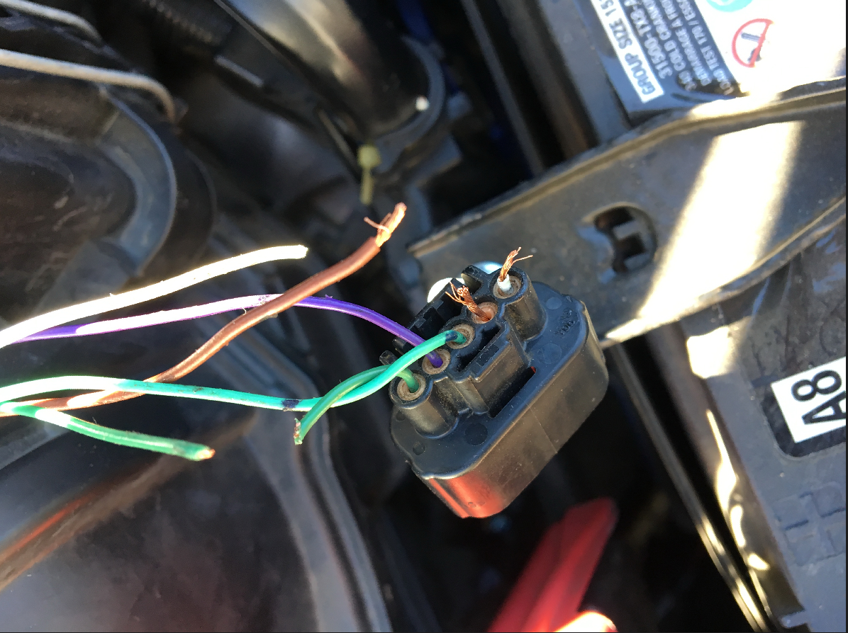

A rabbit somehow got into my engine compartment and chewed a wire, anyone knows what the part number for it? I tried looking online through a few Honda Parts sites but can't find it. TIA!
Car: 2015, Fit Ex CVT
Here are the images of damaged wires chewed by the rabbit!
Again, TIA. And you can see on the 2nd picture, some rabbit hair!

Okay after not finding the part number, I went ahead with my tools, heat gun, connectors, electrical heat-shrink tubing and electrical tape...
Damaged wires
damage wires from rabbit
reconnecting wires
reconnecting, fixing wires
result
result
Now all warning lights are gone.....
But after driving and testing out the car, my AC was not cold at all. And this is was what I found.
Rabbit chewed through the AC wire too.
Anyway, fixed that also... now AC is cold again.
