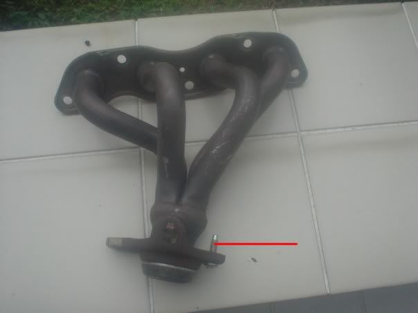

You better look and see if those are the same as your car. As far as I know they are USA ONLY headers. In other parts of the world the collector area is different and the non-USDM ones have longer pipes not the shorties like the USDM one.
This is a non-USDM header. Note there is NO 0-2 sensor in the header ours goes into the front of the converter. So look under you car and check before you order yours.
