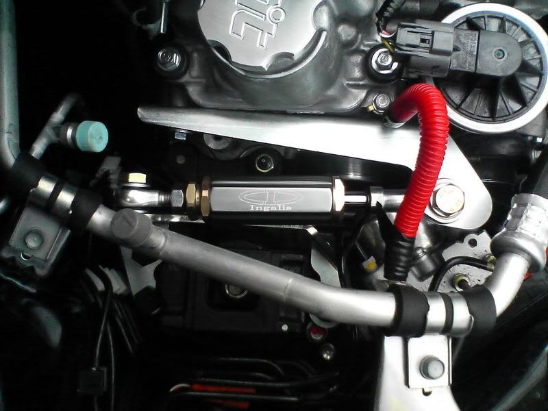

Just installed this last night! Noticable reduction in engine movement, wheel hop, smoother shifts, and better throttle response. Money well spent IMO... (pic below). Got mine from Panducky Motorsports

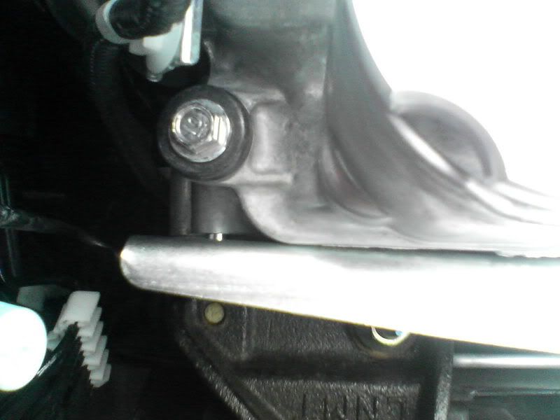

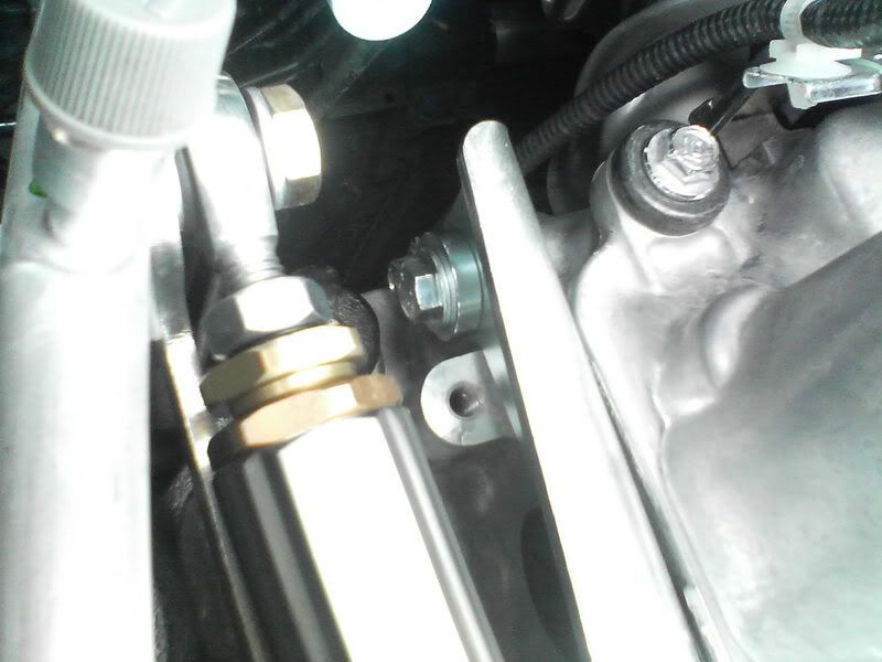

EDIT: I found the problem within 5 minutes of making this post. When installing the engine bracket, i guess i wasn't paying attention and installed the small spacer on the wrong side of the bracket, causing the bracket to be touching the engine. I will fix when i get out of work and post pictures of how NOT to install the ETD
EDIT 2: The 1st pic below is the WRONG way to put the spacer on, although i doubt any of you will be dumb enough as me to put it on backwards. But here's what I did...
The spacer to the upper-right of the ETD is supposed to be IN BETWEEN the bracket and engine, for obvious reasons. Why my dumbass put it there i will never know.
^-----This is the result of putting it on the wrong side: The obvious GAP between the bracket and engine to the left, as well as them touching a bit further right. It was this contact that was causing the sound. Honestly, i was starting to like the sound.... a lot But it can't stay so as soon as i get outta work, im gonna fix it, and maybe post sum pix 2morrow of how its supposed to look!

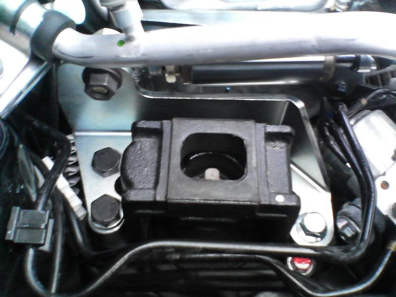

can u tak pics how how it is mounted on the other side. i see that it is mounted on the engine block but want 2 see the other side

There is a preload adjustment, 15mm being the softest, 10mm being the hardest. mine's set to ~12.75mm. So far very little difference in vibration, and only if your sitting in the drivers seat. Once i move the spacer to where it should be, i think it should get even better. I'll take a pic of the chasis bracket in 2 minutes, be right back
Here's the chasis bracket, how's that for service?

thanks that was very helpful since i plan on makin my own

if you look at there install directions to, I think you installed the washers on the damper itself wrong, like there should be a rubber washer on both sides of the damper on the bracket . . .kinda drunk . . .will explain more tomorrow, but look at the install pic, looks like they put both washers on the left side of the damper on the chassis bracket if your looking at it from the front of the car . .

I think you better check the bolt on the rear part bracket also. The bolt is only engaging a few threads it doesn't even come out to the end of the nut. That is going to vibrate off very quickly.

Earthmover and Claymore - Thanks for pointing that stuff out! I'll be getting in contact with either ingalls or panducky to make sure everything is on good. There's a lot of hardware, and the instructions can be very unclear at points. I'll let you all know of any other changes i make in the near future.

small update: fixed the setup a few weeks ago, and all is well...
I put the washer where its supposed to go, and double checked everything. Now its very smooth, no noise, like it's supposed to be. It vibrates SLIGHTLY when its very cold out, like today, but besides that, it seems pefect. Thanks for all the help guys!
