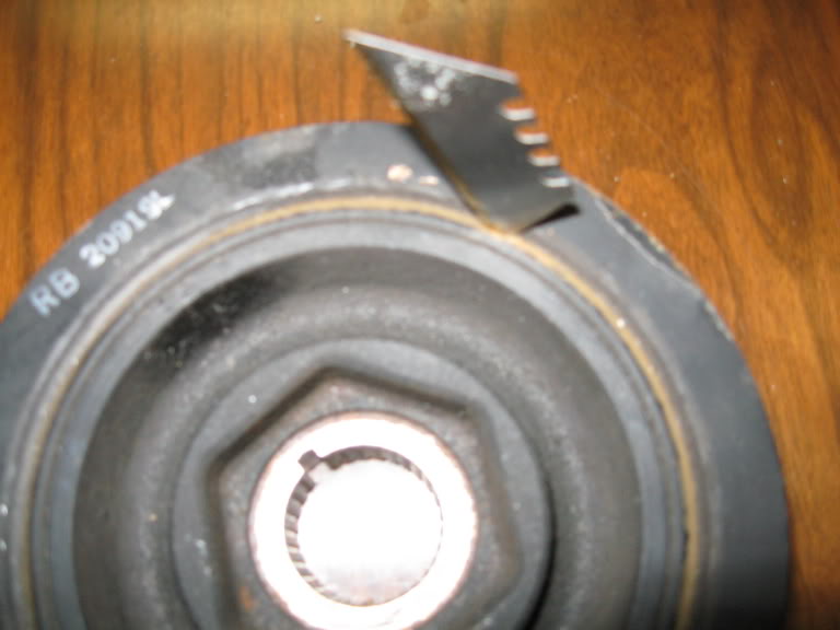

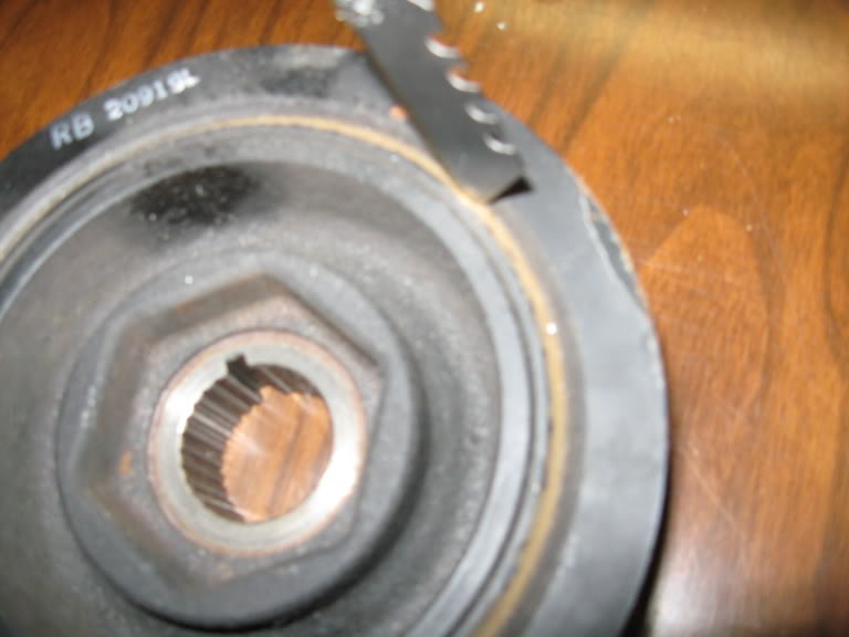

Eldino here is a pic of what Oscar Jr. Is talking about
this is a honda pully, and here is the materal in that hes talking about. see how that razor blade is sticking in it. Rubber like materal used to dampen

Thank you for the pictures jpax!
No, we did not blow it up! Actually, your engine is pictured front and center in our instructions.
