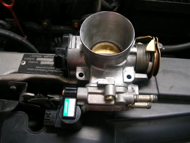

the throttle looks like this from the front:

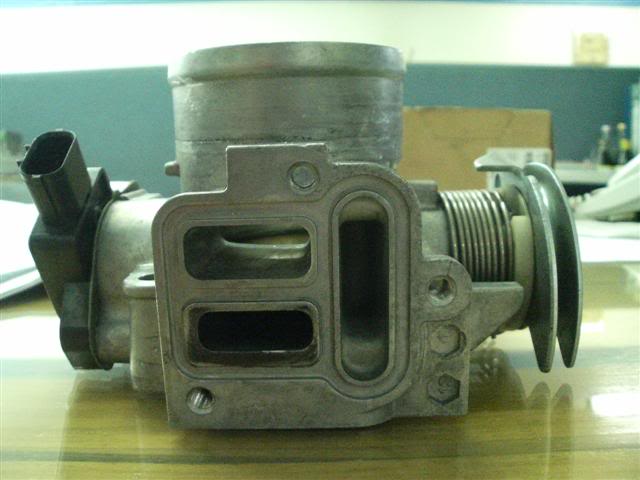

and the ports for the IACV which is mounted under the throttle body:
and the rear of the TB, noting the port under the round throttle which allows for idling air through the IACV to pass into the intake manifold:

here is a pic of the throttle body with the iacv installed under it. note the fittings on the side of the iacv where the coolant hoses attaches to:
