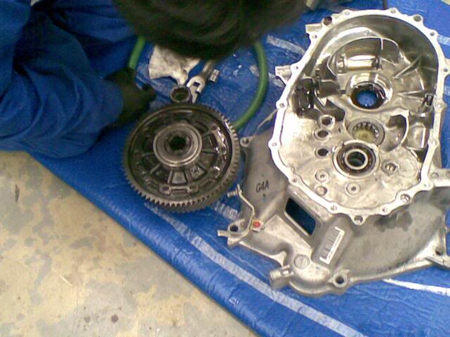

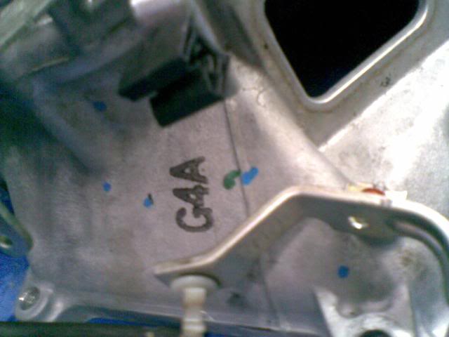

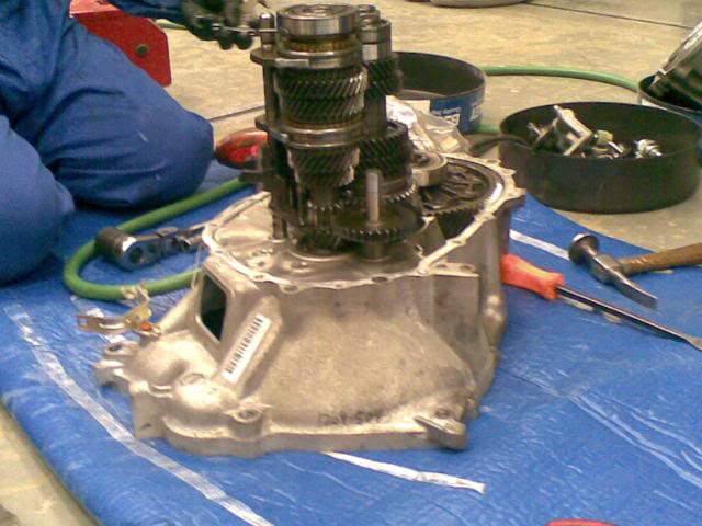

My brother started to remove & disassemble my Fit's transmission last Friday to install the final gear, LSD & clutch set. We have 90% of the tranny Re & I shop manual print out with us that day. Which made the job quite a bit easier for us. I did get two brand new differential carrier bearings & all the shims that are listed in the manual. Finally, the Fit transmission(code#G4A) is out & ready to be disassembled.....

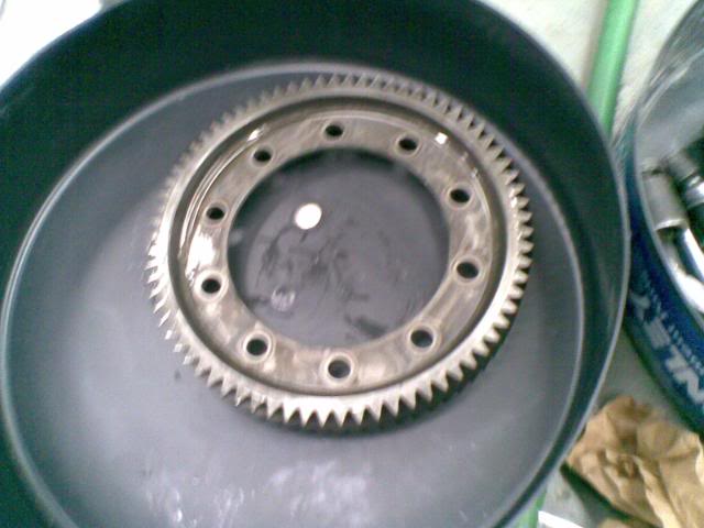

Stock 4.3 final gear!

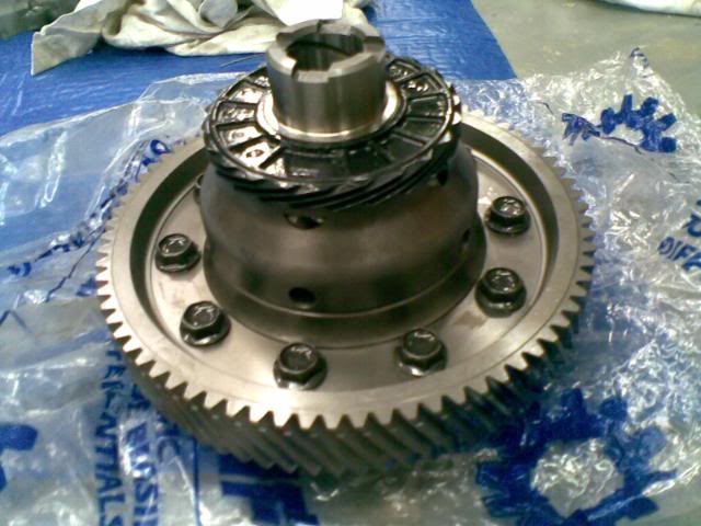

Here's the brand new Quaife ATB LSD with mFactory 4.7 final gear. Now look at the black gear on top of the LSD which sits right between the top differential bearing & the diff assy. That's your Fit's vehicle speed sensor(VSS). Now the problem is, if u don't have the proper tool to help pulling or press the bearing out, like a bearing seperator, and u don't have a brand new VSS sitting there like me. Then u're risking to break it, coz it's made with PLASTICCCCC! We got lucky to pull that mofo bearing out without breaking the VSS thank god, although that took us quite a bit of time.

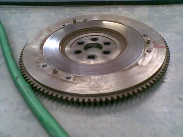

Here's the stock flywheel before it get machined:

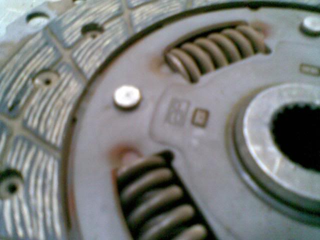

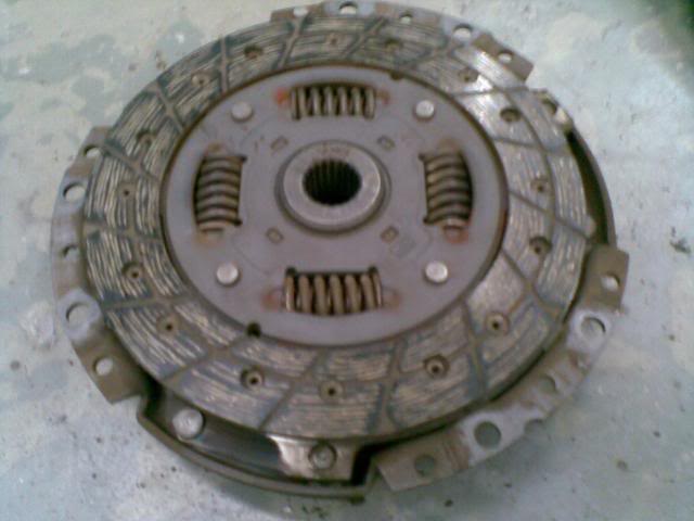

Stock clutch, which is made by AP! Whoa.......
