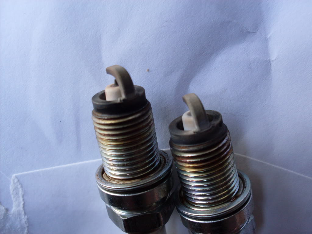

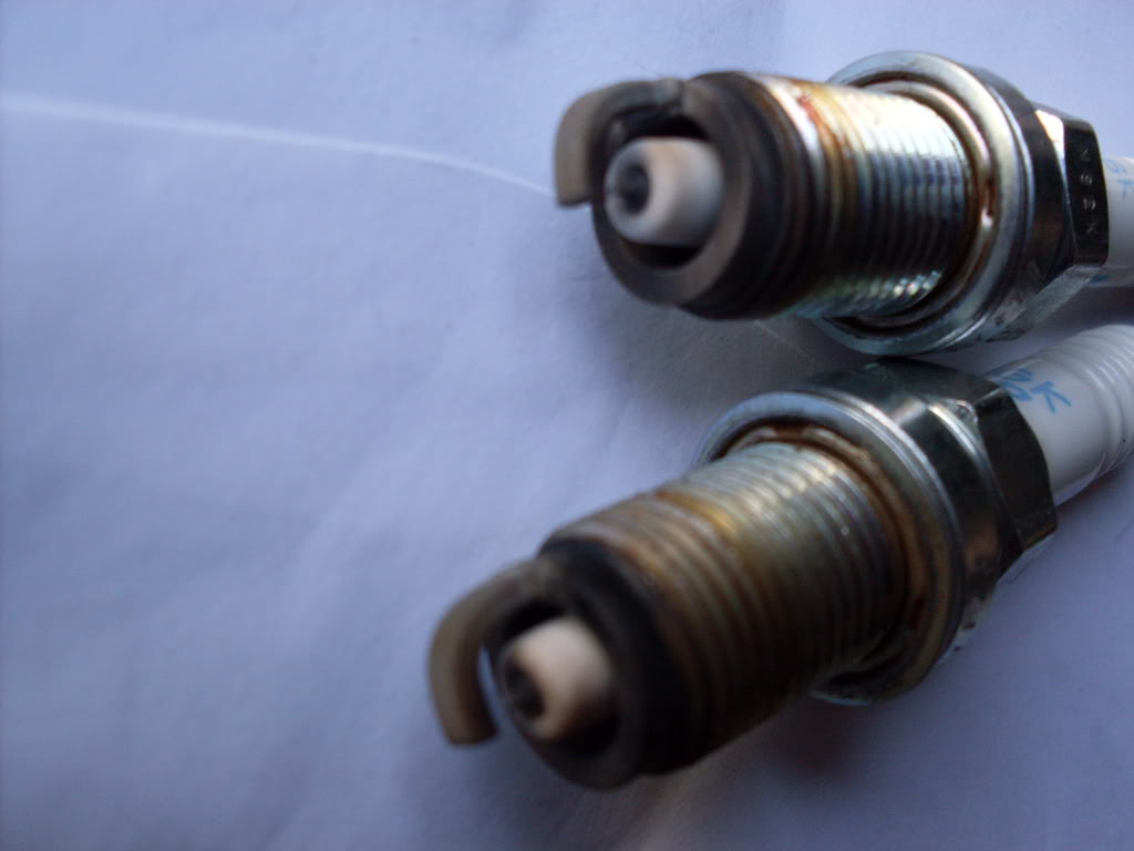

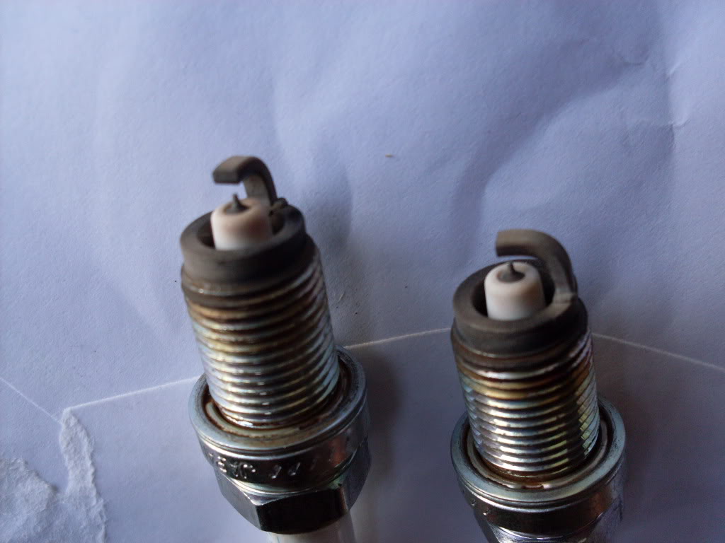

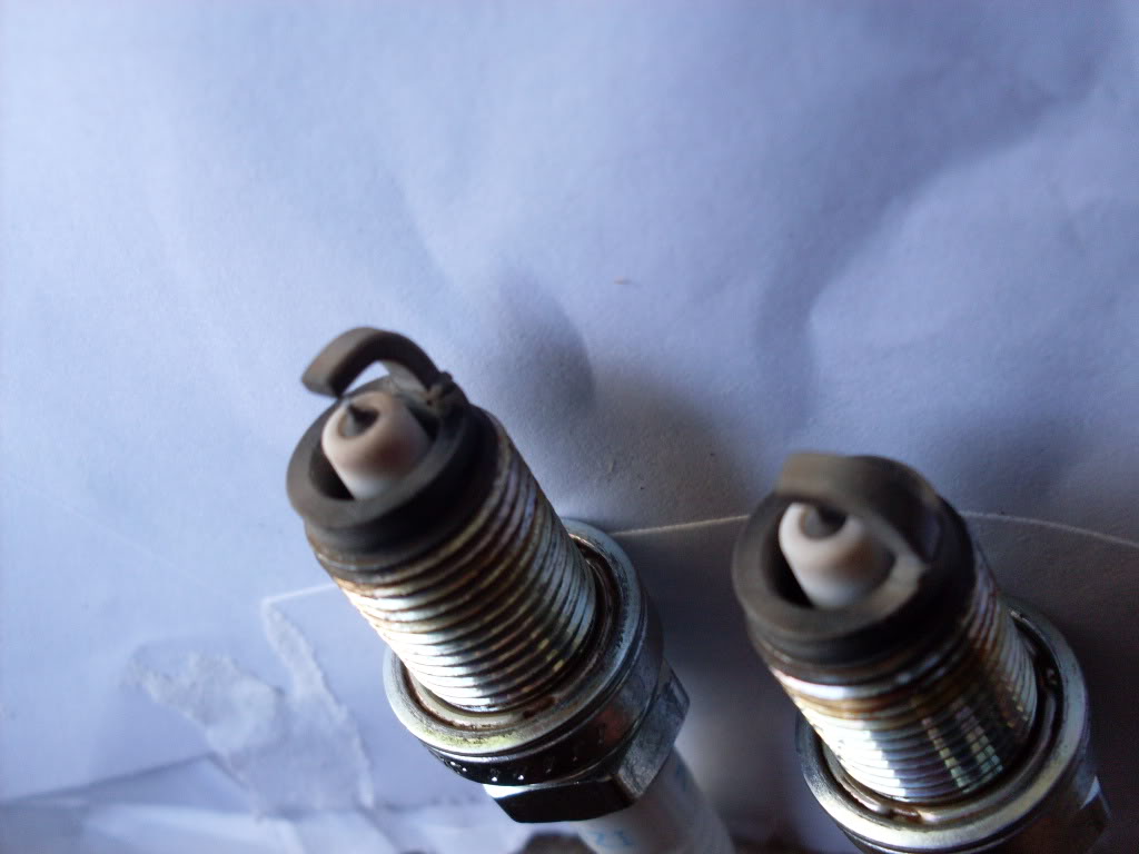

so here are my plugs running 14.1 to 13.8 at WOT, I'll be glad to take any opinions Name:  SDC13638.jpg

How did you do the WOT test? Did you run WOT and shut the engine off at WOT ?
They dont look to bad at all.

sorta, I went out and did a WOT run and came back and I let it idle for 3sec then shut the car off

not bad. . . .but to get a more accurate reading of WOT, try going WOT as long as posible, shut it off and coast back. Then check the plugs. . . .its how we do it at the racetrack, ofcourse its only a secondary measure since we run wideband O2 reader and EGT

I have the AEM wideband but people are telling me im running lean but when I look at my plugs they look fine
