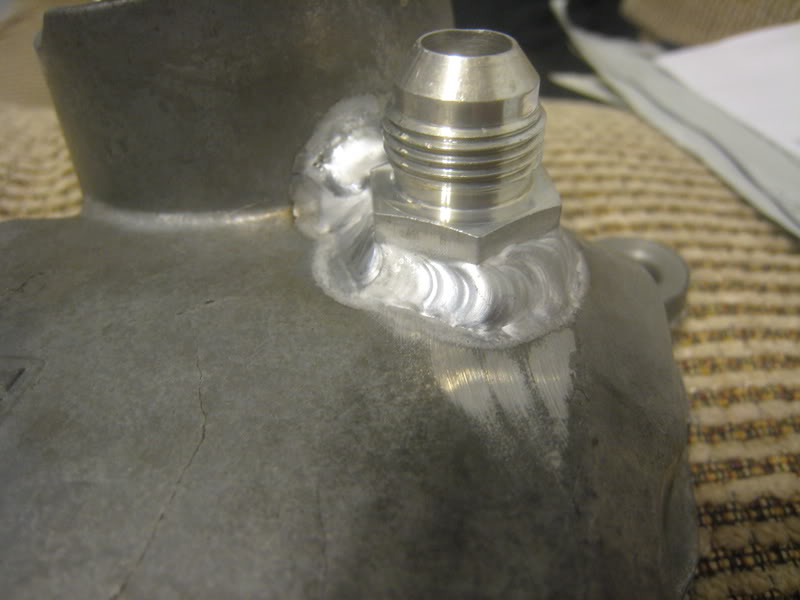

Old Aug 20, 2009 | 10:53 AM
gd3kamiwanaB's Avatar
Luvs Dah b00st!
Posts: 1,253
Size:  89.9 KBName:  IMG_2930.jpg

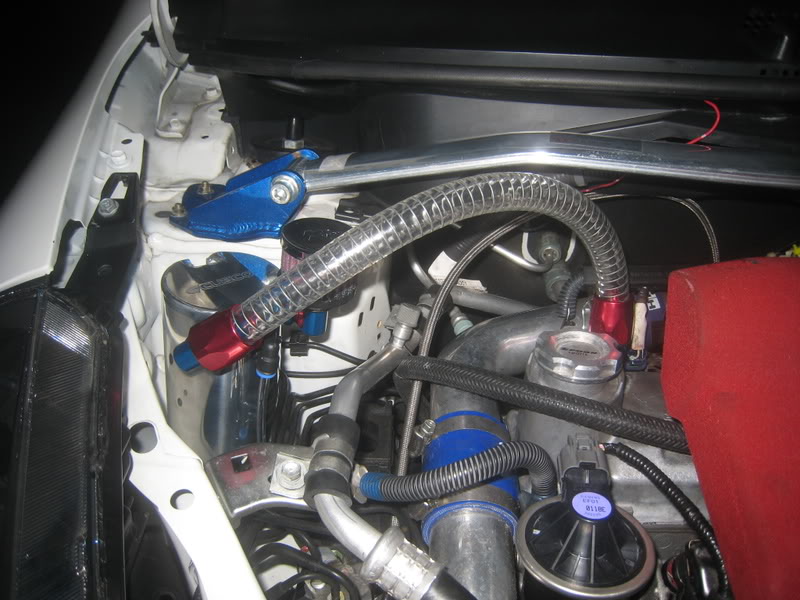

Old Dec 20, 2009 | 11:36 AM
BlueCell's Avatar
Posts: 2,847
From: Yeehaw!
New catch can setup
Old Dec 20, 2009 | 01:36 PM
Texas Coyote's Avatar
Posts: 7,388
From: Anderson County Texas
Where can I get a filter like that.... I swear that it would be a great microphone for playing blues harp by just wiring in a condenser element.
Old Dec 20, 2009 | 01:45 PM
BlueCell's Avatar
Posts: 2,847
From: Yeehaw!
Bought it at Topspeed auto accessories up here in Dallas.
