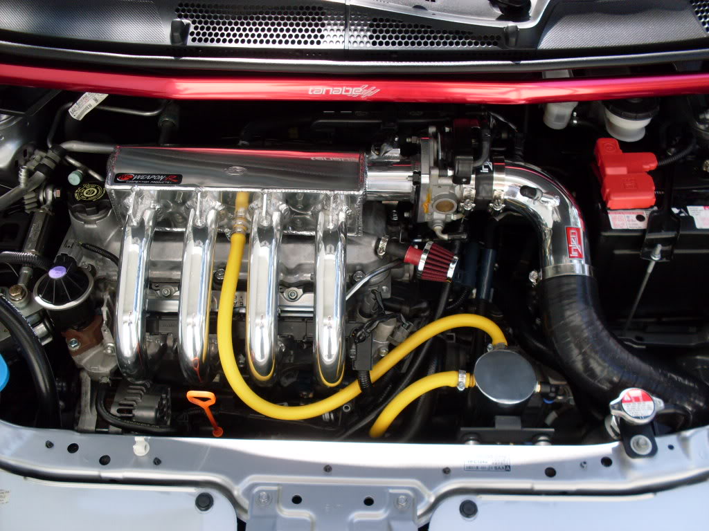

I've seen several threads on several forums discussing the different ways to mount an oil catch. I'm just curious, which way is best for NA motors?
The general consensus seems to be PCV -> Oil Catch -> Intake (manifold)

Ya I saw that thread but I also saw that Josh (gd3kamiwanab) had his mounted/connected to the other side of the engine.
I wonder if the cusco one has any type of filtration in it so I can hook it up to the PCV.
Also, once this thing fills up with oil, how Do I empty it? I really need to learn to read Japanese LOL. No English documentation FTL

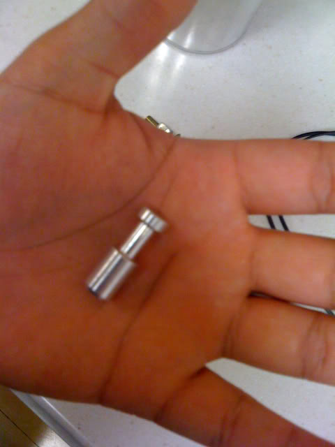

I was looking through all the hardware that came with the catch can
WTF is this thing?
Also, would anyone be able to post up pictures of how they mounted the brackets?

In the picture redrumm posted I used the stock air box bushing's and that metal piece that goes inside,then I used the radiator mount hole and drilled another next to it.

Anyone know what that piece is used for?

Still curious what that piece is. Anyone?

I would guess that it is a filter.

meh, your probably just paranoid as far as alot of sludge. by no means is it something bad to add. as far as that bit from a random kit, phhhh, no clue, but I could easily source it down for you in person.

That piece is a plug. I had one for my Subaru when I changed the intake but I don't think I used it. I think it was for combining some vacuum lines or something so the plug was to be used in one of the empty holes but the intake I used was already one less than stock.

can we have a detailed photo showin exactly where the second hose connects to the engine the bit we currently can't see from the above picture?
Please
