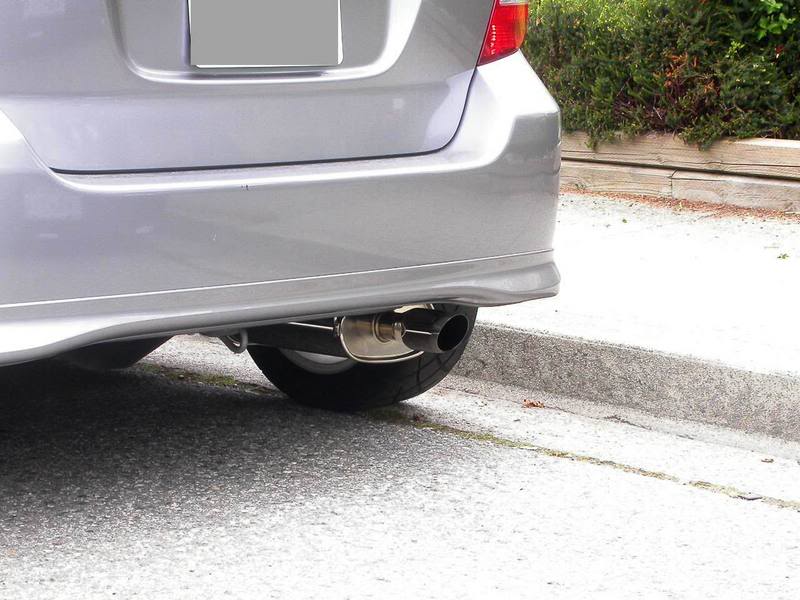

Here are some examples of N1 & sports muffler setup:
spoon N1:
J's racing
Sports muffler
T1R 50s ver2
Spoon sports type muffler:
Fujitsubo(FGK) Wagolis muffler for GE
I guess u have a better idea on the difference between a N1 muffler & a sports muffler by now. N1 mufflers got a small can with big/small tip, straight through design & they're pretty loud usually. On the other hand sports muffler got bigger can, straight through/dual chambered design & provide a lower tone usually.
SS RICH: I've tried quite a few exhaust setup on my 07' Fit MT both on the street, at autocross & lapping events also. I would recommend u to go with just a sports axleback muffler in your case. The fit's 1.5L block is definitely wayyyyyyyyyyy smaller than what u have/had in your 11sec camaro so it's not a good idea to put a high flow exhaust, especially on a AT fit. U don't wanna sacrifice that weak enough low end torque & throttle response for that tiny little bit of high end power.
HFP/T1R 50s ver2 are both nice & easy to get. Or u can get the FGK wagolis muffler also if u got a little more budget. U will definitely have a hard time to talk with your passengers if u use a N1 design in an AT Fit coz the transmission always keep your engine running at around 2500-3000rpm, maybe lower, which I find pretty annoying & it sounds.....pretty stupid(hope u don't mind me saying that).
