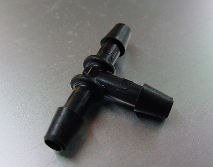

I had bought a USED low boost MT kit off of another forum member here who had run the rotrex unit dry and the unit seized. I picked up a new supercharger/oil filter/air filter/reservoir from kraftwerks so all the important parts of the kit were new. I installed the unit over a weekend an ended up with a one in a million issue with the rotrex unit. kraftwerks replaced the unit with a brand new unit no problem.
I got the new unit installed and took it for its first test drive. I experienced problems with the car having good power under part throttle but not under full throttle. So I gave them a call again and explained the issues I was having with the car and they said they would take a look at the install. I had the car towed out to their shop first thing this morning and they said I had everything hooked up properly and that the install looked great, so they hooked it up to the dyno and right then they could see there was a problem, vacuum was not registering! The supercard was not seeing any vacuum or boost! Oscar Sr. checked the (local auto part store) T fitting that was in the vacuum line and it was not molded correctly! The T was only flowing air in 2 of the 3 outlets, so my boost gauge was getting vac and boost but that was the end of the line. These lines were all pre-assembled from the previous installation, so I can only assume the previous owner had trouble with the kit as well since this T was originally for his boost gauge. Oscar replaced all vac lines with oem quality line that is shipped with the kit and installed a oem quality T fitting. The power loss at full throttle was from the car not having fuel and running lean! Very scary, as the motor could have popped! Oscar said the reason I wasn't seeing a cell pop up for the lean condition was that the car has to go through 3 cycles of start up with lean conditions first.
AGAIN, I can't thank kraftwerks enough! There dedication to putting out the quality piece of kit for our car and backing it 100% is nothing short of an amazing company, they love what they do and I think you would be hard pressed to find a company more knowledgeable to buy from. They went out of their way BIG TIME to help someone with a USED kit. They had every right to turn me away but they didn't! They have me as a customer for life!
Oh and the car made 3 great pulls and worked awsome! I will post the dyno once I get it.
This is an example of the piece that was molded wrong

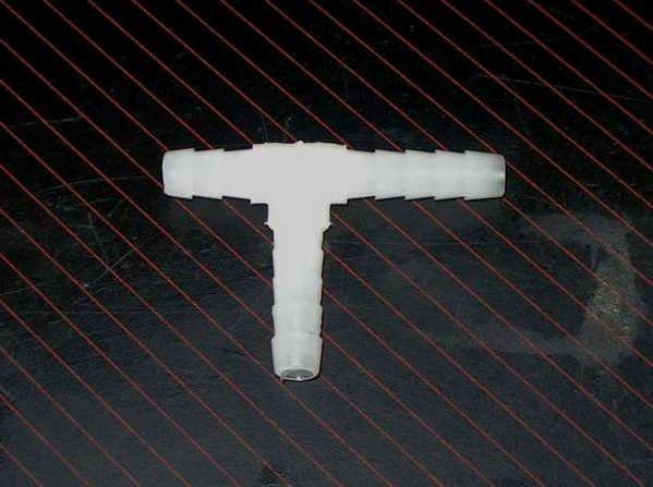

This is what the OEM quality piece looked like that kraftwerks replaced it with

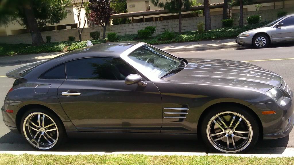

Anyway I've not been on the site for a while as I picked up a new toy.

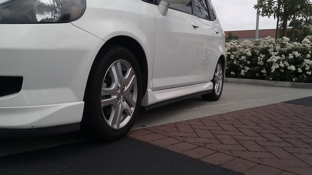

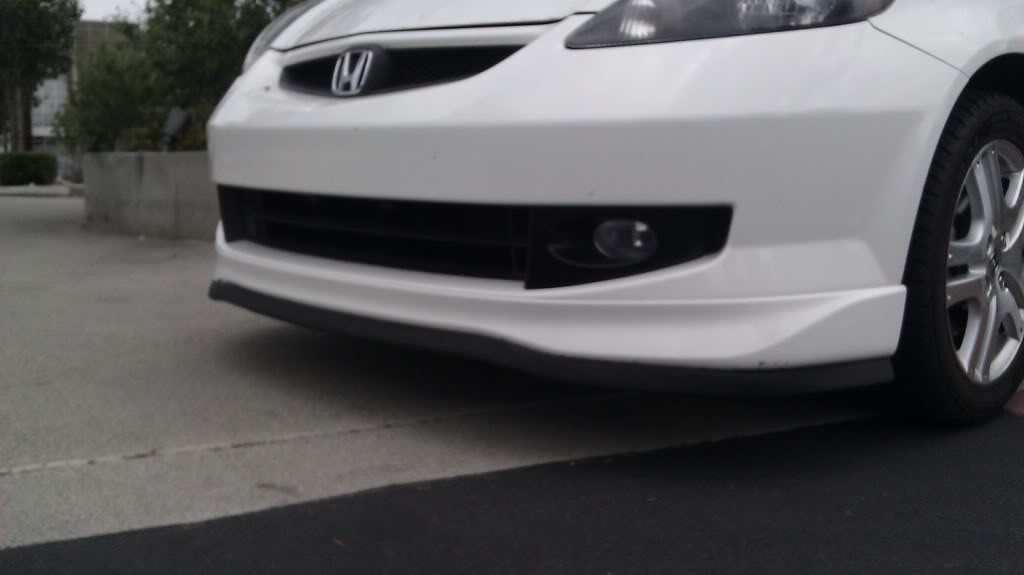

So on the fit I've put on a Seibon carbon spoon style spoiler. I've also done the rubber "lip" on the front and side skirts to improve airflow under the car. I am surprised how much it has stabilized the car in crosswinds I'm sure it somewhat helps on gas mileage too.

Very nice Crossfire. What is the name of that color and is it a SRT-6 model?

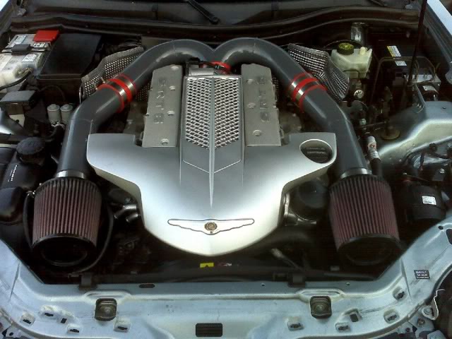

Thank you, the color is "graphite metallic" and yes it's the SRT-6. You can tell the SRT version by the fixed wing and a front lip. The regular crossfire's wing retracts and the bumper is rounded instead. I've since installed a twin intake setup and re-valved Koni shocks since I picked it up 3 weeks ago.
Made 331HP and 310TQ @ the wheels with the intake.

I do dig the twin intake setup and even more surprised that it actually makes that much power. What size is the supercharged V6? I used to say to myself that these need a 5 or 6 speed M/T and a Hemi... but after seeing those numbers not so much anymore.

The car is actually a Mercedes SLK 32AMG chassis code R170 model. The chassis is then sent to Karmann coach builders for the body and interior. The car is 100% German and shipped to the US. There were only 2016 Coups and 880 or so convertible SRT-6's ever built.

3.2L Twin Scroll supercharger motor.
These cars are in the 11's with a pulley, intake, open exhaust and a tune. That being said I care nothing for drag racing!
