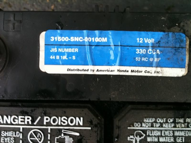

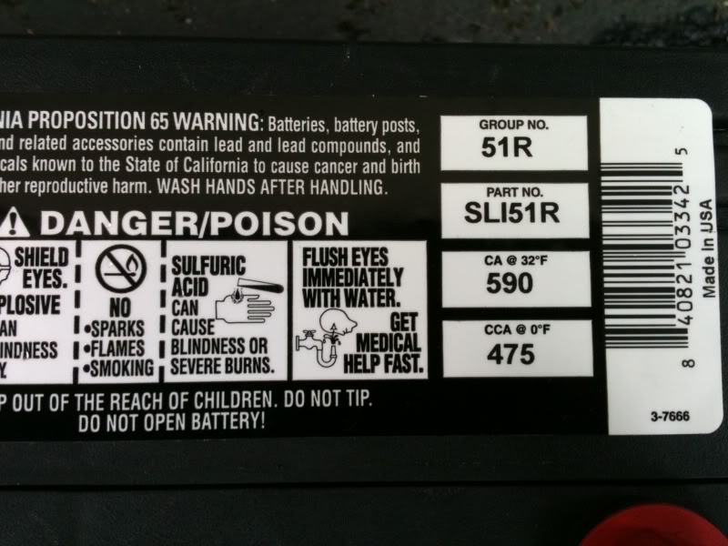

I have an 07 fit from April 06 and my second honda battery is already on it's last leg. I picked up a 51r from suggestions on this site as larger option. Here is the modifications I made to make it fit. I picked up a sli51r from batteries plus for about $60.
Comparison of battery sizes.
Old Honda Rating
New Battery Rating

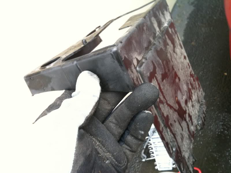

Bottom Tray Modification

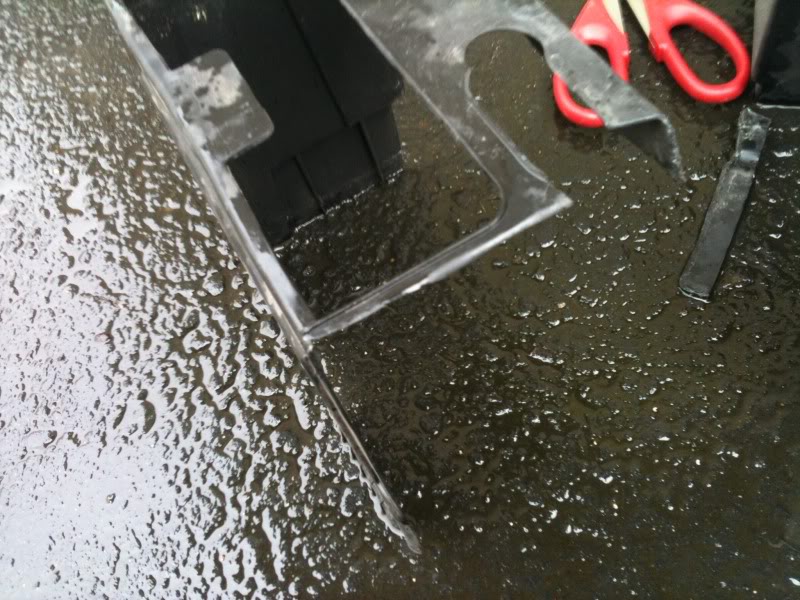

Top Cover Left Side Modification
Top Cover Right Side Modification

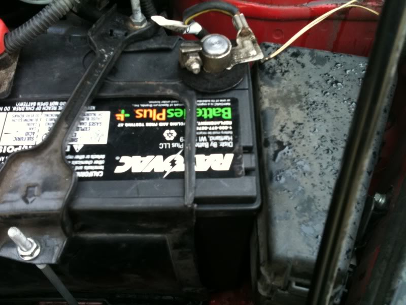

Installed

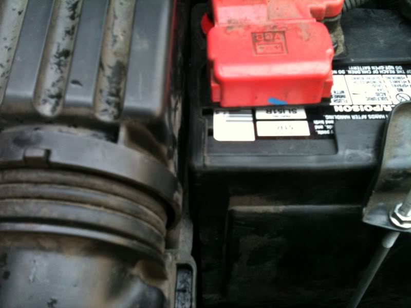

Right side clearance (none)
Left side clearance (none)

You probably got your 51R recommendation from me. I've been posting about it for years. I just removed the tray and cover (but kept them). I'll be doing this mod today. Thanks.

How tight is it against the junction block? Is it putting pressure on it, or just up against it?
No pressure on junction block or intake. Just barely fits, but it does fit.

Folks, there's way too little clearance to the intake. What happens when the engine begins moving a little? Bang, bang, bang...
The engine doesnt do a whole lot of rocking side to side first of all, second the intake box is plastic, and there are now a couple people who've done this with no issues. If the engine is moving that much laterally you have other problems, like bad motor mounts.
The Intake pipe and TB have a soft coupler and are able to move. If it was a "serious problem" as you claimed in the other thread we would have heard something.
Stop spreading bad information, you've done it in two seperate threads now.
