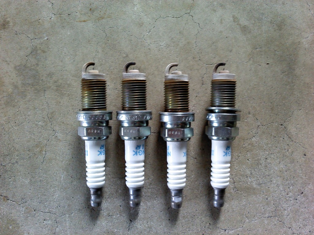

Here are my factory spark plugs after ~104k miles:

The third plug does look like it ran a little hotter than the other three, but nothing crazy. Other than that, just normal wear. It seems some owners have had issues with the third cylinder spark plug and coilpack - I don't know if this is why mine looked a little hot, but I'm not too worried because I thought it looked good for having been in there >100k miles.

doctordoom, those plugs look like your engine is running optimal A/F and electrode still looks like it had plenty of life left.
